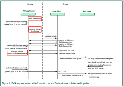

Sorry, I made a mistake. We don't know how to customize the boot animation. Because M4 controls the display at the beginning, and finally Android controls the display.

Refer attachment 8.1.1 Interfaces to control the EVS function
This is in M4.
