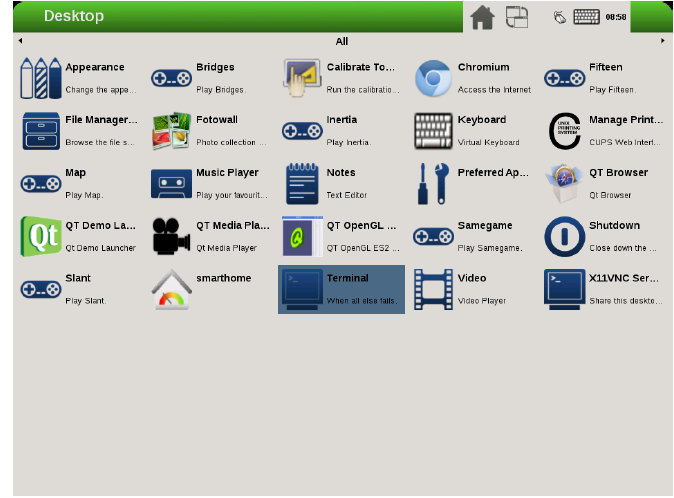

Hello NXP team,
We have a question need your help.
After yocto system boot completed, there is no application icon on the desktop
How to display more icons and applications on the desktop on Linux version 4.14.78_1.0.0,?
we hope to get the desktop result like the attached picture.
