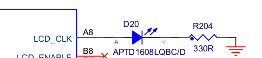

Pls, Can any one suggest how to diasable LCD_CLK pin A8 in imx6ull.
Currently in my design I configured LCD-CLK pin as a GPIO but at initialization time(power up time) default 9MHZ clock is coming. So I want to disable that clock.
By using any PLL or any other one is there to disable that LCD_CLK?imx6ull gpio isssue.png

Hi prabhu
one can try to disable clock using CCM_CCGR2 register in uboot or dcd header
mx6ullevk\freescale\board - uboot-imx - i.MX U-Boot
