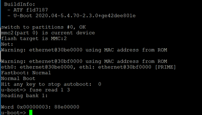

kirankumar007
Problem-1
1)We have I.MX8MP EVK has default image, stopped at u-boot using putty and checked below register JTAG
From above image JTAG Disable permanently one of of the NXP Support aslo given message.please confirm

bernhardfink
On my EVK boards the JTAG is enabled, the two lock bits are not set:
u-boot=>     fuse read 1 3
Reading bank 1:
Word 0x00000003: 88000000
1) The JTAG port on your EVK is disabled by the fuses.
2) The BOOT_MODE[3:0] pins need to have the value '0 0 0 1' to force the i.MX 8M Plus into serial downloader mode.
Pin Name Ball Value for USB download
BOOT_MODE0 G10 1
BOOT_MODE1 F8 0
BOOT_MODE2 G8 0
BOOT_MODE3 G12 0
On the 8M Plus EVK this is easy to make, there are DIP switches near to the PWR switch, marked with BOOT_MODE.
