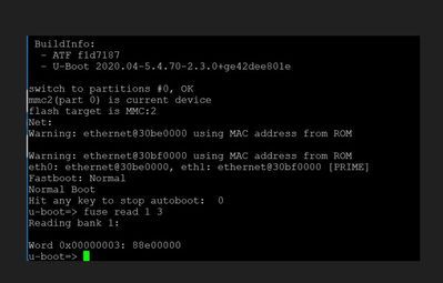

When we are read the bank 1 word 3 in I.MX8MPLUS after the U-BOOT ,we observe the below value.
Does it means ,Is JTAG is Disable?
You said that  SJC_DISABLE  and JTAG_SMODE are set high ,that means JTAG is Disable.
Does the I.MX8M  fuse address are applicable for I.MX8MPLUS ?.

You seem to have a closed part. All 3 relevant bits are set. Bit definitions and the location are valid for i.MX 8M Plus.
Make a crosscheck with a debugger, if you don't see any core appearing, then the JTAG is definitely closed.

Problem-1
1)We have I.MX8MP EVK has default image, stopped at u-boot using putty and checked below register JTAG
From above image JTAG Disable permanently one of of the NXP Support aslo given message.please confirm

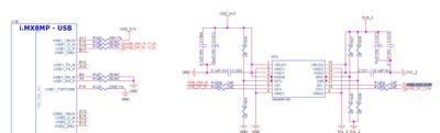

1)We have custom board(i.MX8MP) doesnt have default image, any procedure for JTAG Access. Is it possible any where without default image JTAG access is possible????
2)If possible means how decribe procedure
3)if not, USB connections out cutstom device shown below
Its USB2.0 in EVK Type C connections given, said USB2.0 also compatible,then please given a procedure with our hardwrae and software loading using USB2.0.
Many days happen request you give clear and stright procedure for all of above

On my EVK boards the JTAG is enabled, the two lock bits are not set:
u-boot=>     fuse read 1 3
Reading bank 1:
Word 0x00000003: 88000000
1) The JTAG port on your EVK is disabled by the fuses.

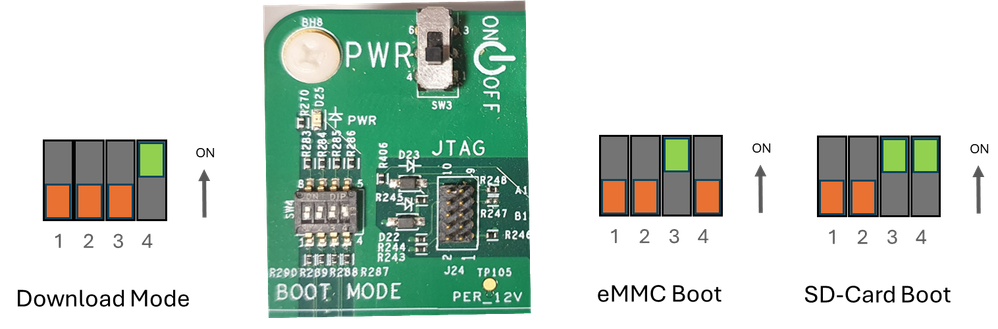

2) The BOOT_MODE[3:0] pins need to have the value '0 0 0 1' to force the i.MX 8M Plus into serial downloader mode.
Pin Name Ball Value for USB download
BOOT_MODE0 G10 1
BOOT_MODE1 F8 0
BOOT_MODE2 G8 0
BOOT_MODE3 G12 0
On the 8M Plus EVK this is easy to make, there are DIP switches near to the PWR switch, marked with BOOT_MODE.
The USB connection on your custom PCB seems to be perfectly fine, if you succeed to set the BOOT_MODE pins correctly, you should see the i.MX 8M Plus going into SDP mode after power-on:
