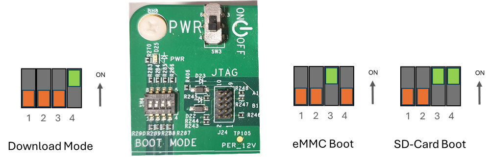

911 Views

1) The JTAG port on your EVK is disabled by the fuses.
2) The BOOT_MODE[3:0] pins need to have the value '0 0 0 1' to force the i.MX 8M Plus into serial downloader mode.
Pin Name Ball Value for USB download
BOOT_MODE0 G10 1
BOOT_MODE1 F8 0
BOOT_MODE2 G8 0
BOOT_MODE3 G12 0
On the 8M Plus EVK this is easy to make, there are DIP switches near to the PWR switch, marked with BOOT_MODE.
The USB connection on your custom PCB seems to be perfectly fine, if you succeed to set the BOOT_MODE pins correctly, you should see the i.MX 8M Plus going into SDP mode after power-on:

Bernhard.
