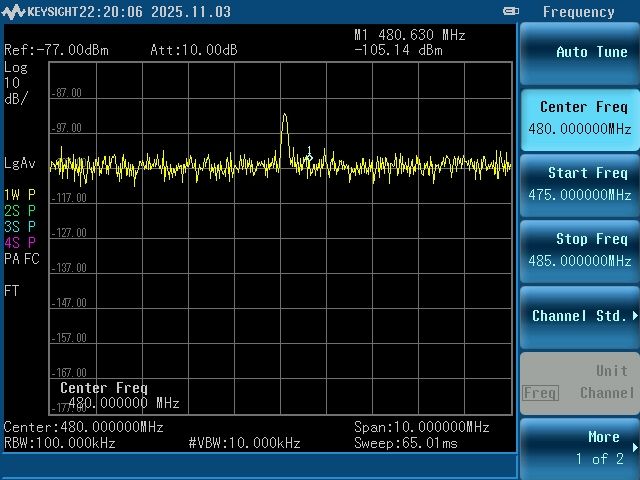

102 次查看
bernhardfink
Hi Bhardwaj,
even if USB 2.0 is not that fast, the wiring you did to connect USB may impact the electrical quality of the D+/D- signals too much. Could you try to make the wires shorter?
There is no real indication to the outside, that the USB block is enabled. If you have a spectrum analyzer, then you could try to catch the 480 MHz radiation from the USB PLL on top of the 8M Plus.
I did it with a simple antenna probe (thin wire, 20 loops, connected to an RF cable) and the settings below.
Bernhard.
