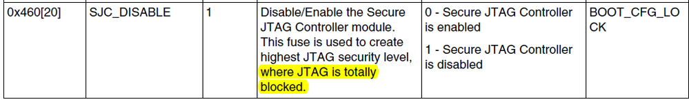

The correct OTP fuse to blow is SJC Disable:
Not sure why our i.MX8 Reference Manual refuses to define this fuse, but previous i.MX family parts did define this pin:
