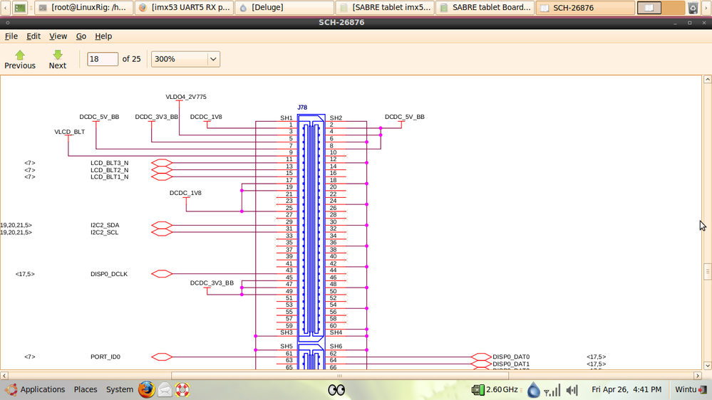

Dear Friends,
        I am working on imx53 sabre tablet (imx53_smd) board. So far I am successfull in testing most of the peripherals.
Now i am stuck at a point where I cannot test UART4 and UART5. remaining UARTS are working fine.
I suspect from following reasons..
     1. May be UART pads are not defined properly.
         but I have added UART4 and UART5 pad definitions in iomux_v3_cfg_t mx53_smd_pads[] of mx53_smd.c
        these ones :
        MX53_PAD_CSI0_DAT12__UART4_TXD_MUX,
        MX53_PAD_CSI0_DAT13__UART4_RXD_MUX,
        MX53_PAD_CSI0_DAT14__UART5_TXD_MUX,
        MX53_PAD_CSI0_DAT15__UART5_RXD_MUX,
       even I have changed to iomux-mx53.h file as per the latest freescale kernel tree. for al the UARTS.
  2. May be CSI0 interface is not allowing the UARTS to be used.
     the connector on board has a 120 pin QTH connectorin which there are signals for auxillary display and camera
     interfaces (CSI0). On the Same CSI0 interface you will find UART4 and UART5 signals. And I definitely dont need CSI interface.
so my guess is since CSI0 interface is still enabled so i cannot access the UART4 and UART5 signals.
So is there any way to disable the CSI0 interface. ?

         I have another idea ......
    by referring to the i.MX53 Multimedia Applications Processor Reference Manual, Rev. 2,.1, 6/2012
  section 45.51.1 Configuration Register (IPU_CONF)
   so this register is responsible for IPU interface initialization.
   so in this 32 bit register the 0th and 1st bits are responsible for enabling / disabling the CSI0 and CSI1 interfaces.
So i was just wondering if its possible to read / write this register or by OR-ing the value by 0x11111110 disables both the CSI interfaces. I think we can use __raw_writel(data,address);
  Any thoughts?

        I think I found the problem.... Actually I have no idea if UART4 and UART5 are workng fine.. but
I have beent esting the UART4 and uart5 on J78 120 pin QTH connector on imx53_smd board.
   If i look at the schematic of the board i came to a conclusion that the UART4 and UART5 signals are not at all conneted to CPU.
i.e. for UART4 -- 26th and 28th pin
           UART5 - 32 and 34th pin. which are not connected anywhere.....
So no point in testing the UART4 and UART5...
Do u have any suggestions on how can i route the UART4 and UART5 pins to some other pins on the same connector. ?
7,070件の閲覧回数
AlanZhang
Contributor V
Hi, Winston,
You referred to a wrong connector. According to IOMUX config, the nets of UART 4 and 5 are associated with the connector J12, not J78. J12 is a CSI connector that you need to be very careful to wire out nets from it. So I suggest you to prepare an real customized board that follows your hardware spec, then let discuss on that real board.
Alan Zhang
