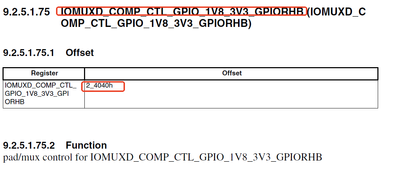

zheliu
I want to read and write this register,
Use devmem to report bus error.
