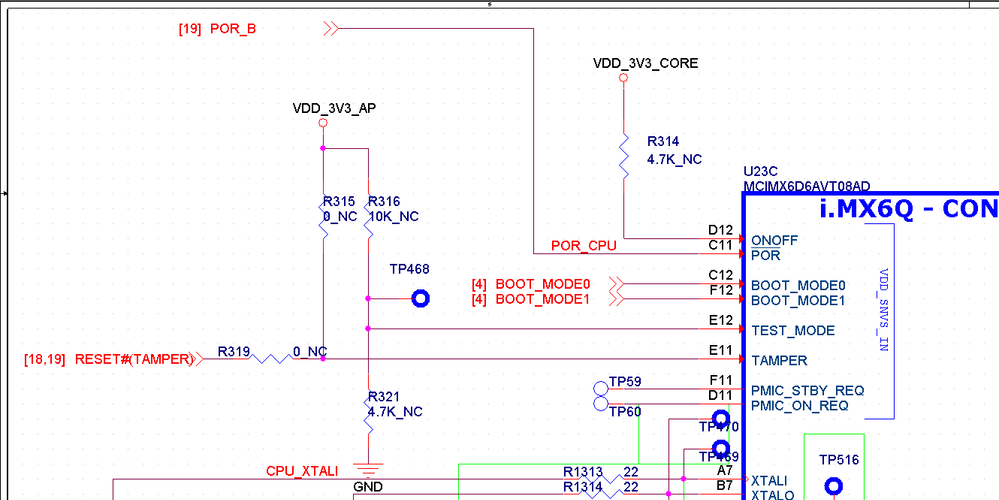

Now,I want to design the board to suit for the soldering test of volume-produce of IMX6D production,just like
  • Open circuit
  • short circuit
  • virtual welding

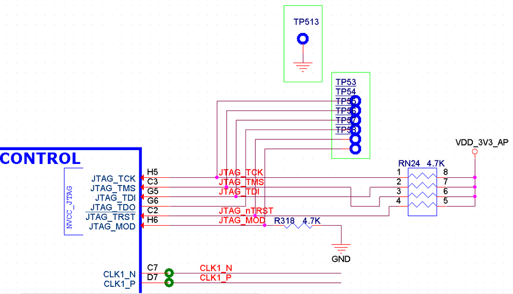

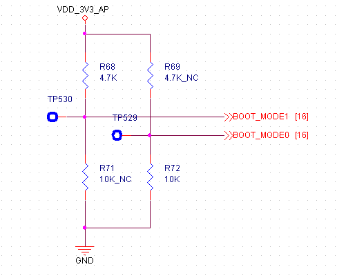

As I know,I add test point on JTAG_MOD,TCK,TDI,TDO,TMS,TRST,BOOT_MODE01,POR, and Is it right as my follow sch?
how to design with the power supplies pin of PCIE SATA LVDS,DSI?
How to test DDR IC and others,for example,ADC,DCDC,EMMC,ST-MCU?

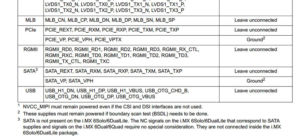

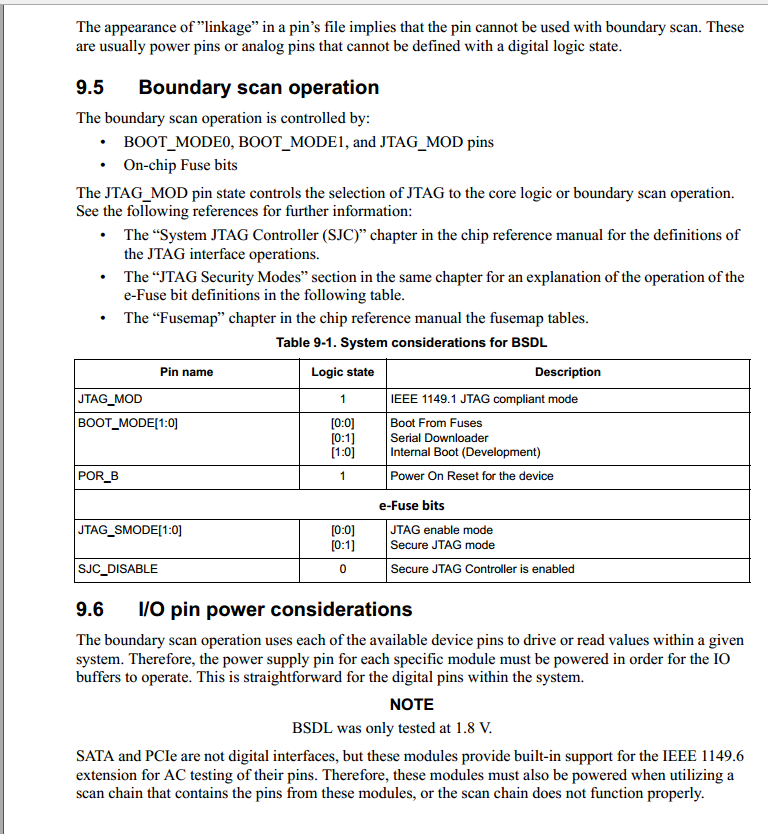

for bsdl test JTAG_MOD should be high level, PCIE_VP, PCIE_VPH, PCIE_VPTX,
SATA_VP, SATA_VPH should be powered as suggested in Hardware Guide.
I am not aware of procedures or additional documentation regarding bsdl testing of
various peripherals. Seems customer should implement necessary module timings himself,
based on datasheet requirements.
