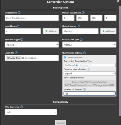

Iam working on imx8mplus yocto project. I have trained object detection model on YOLOv5 on custom dataset. Its working fine on ubuntu pc. Now I want to run that model on my imx8mplus board. I convert the model in yo tflite and try to run the model on tensorflow script but its not working.
How can I run YOLOv5 model on imx8mplus?
Is any other way to run any other object detection model on imx8mplus that support for faster framerate and easy to interface? Also I need to train that model on my custom dataset.

Now I have successfully converted yolov5 to tflite model and tested becnchmark on npu as well following the document you have sent. But now I need example code in python to test live object detection on camera.

What to give option2=coco_label.txt. And what are the changes done to run model at 26-30fps? or what is the best parameter to run like pixel size, yolov5 model(small,medium,nano), number of images to train, epochs.

Please use int8/uint8 for input/output data type, this should enhance the performance.

I have somehow manage to run yolov5s model on board including gpu using tensorflow lite python api, but its too slow and its too difficult to run as compare to yolo.
My question is  that, any library or api is  available like ultarlytics(yolo) for tensorflow lite for detection in python. Like:-
python3 detect.py --weights yolov5s.pt --source 0 --device 0 --conf 0.5
Or I have to learn python and machine learning using tensorflow from scratch?

You may need add NPU delegate support in your python script, please refer here.
