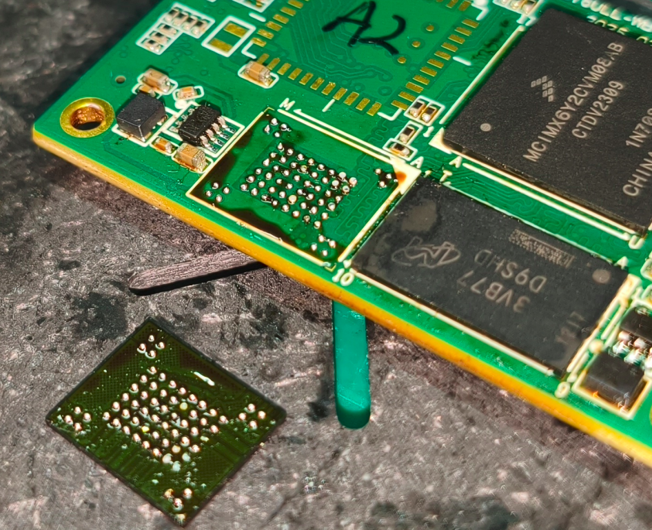

I designed a custom i.MX6ULL board with a NAND flash chip, but it cannot be detected — the NAND ID cannot be read. U-Boot fails at nand_detect.
However, the same U-Boot code works on the vendor-provided evaluation board.
I would like to ask:

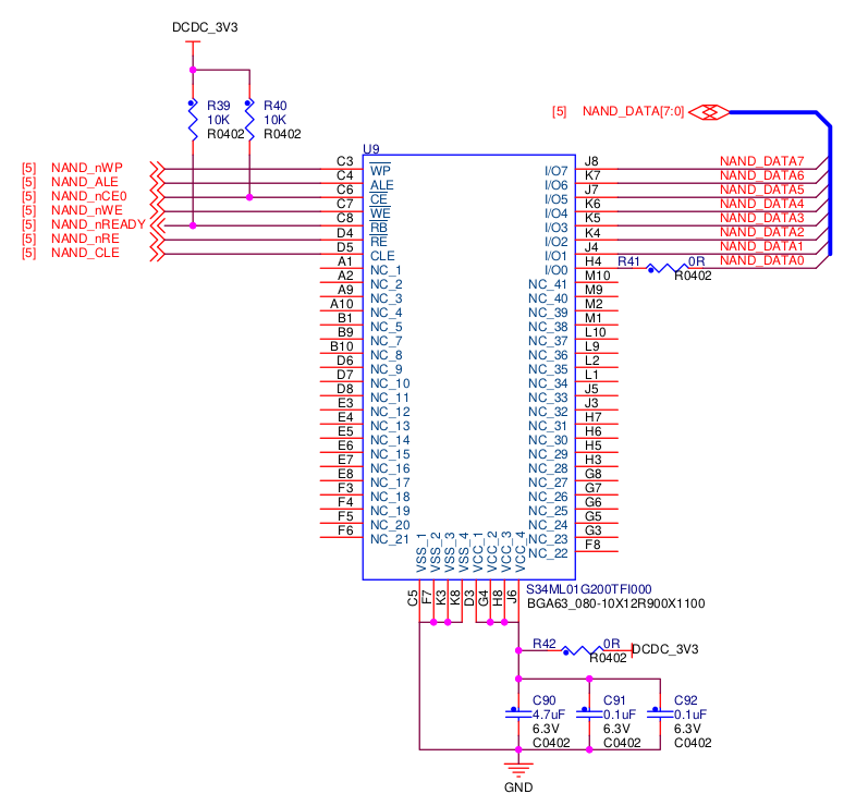

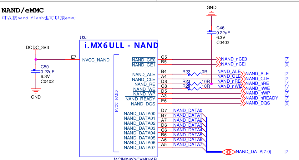

1.   Is the following NAND schematic correct?
2.   How do I verify whether the NAND circuit is functioning properly? Should I begin by attempting to read the NAND ID?
I am currently unable to confirm the soldering quality — the NAND is BGA-packaged — but all four of my custom PCBs show the same issue. After soldering the NAND, I can only measure a few IOs (WE, ALE, RE, CE).
Yes, the NAND schematic is correct. In our reference design, Pull-up resistors are recommended in control signals to warranty signal integrity, this could change according to design and used part numbers.

The NAND flash debugging has been successful. There was an incorrect capacitor selection for the RE pin on the schematic diagram, which should be replaced with an 18pF one.
