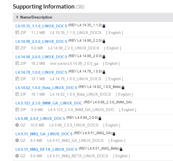

---downloading linux document from the link
Embedded Linux for i.MX Applications Processors | NXP
Supporting informtion
Select one version of linux bsp, and download it's document.
then download yocto BSP and compile it according to steps in "i.MX_Yocto_Project_User's_Guide.pdf",  opencv on python 2 have been included.
