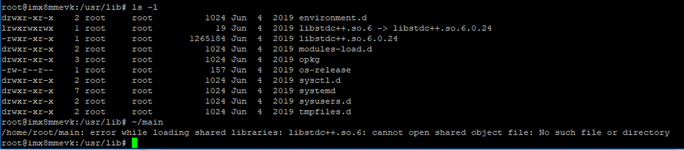

 To do cross-compile with C++, I added conf/local.conf and then I could see libstdc++.so.6 in /usr/lib as below.
But, the below error occurred now..

diegoadrian
Can you please try adding the "glibc" recipe to the IMAGE_INSTALL_append part in the local.conf and see if that solves the problem?

coilnpark
Hi Diego~
Thank you for your reply.

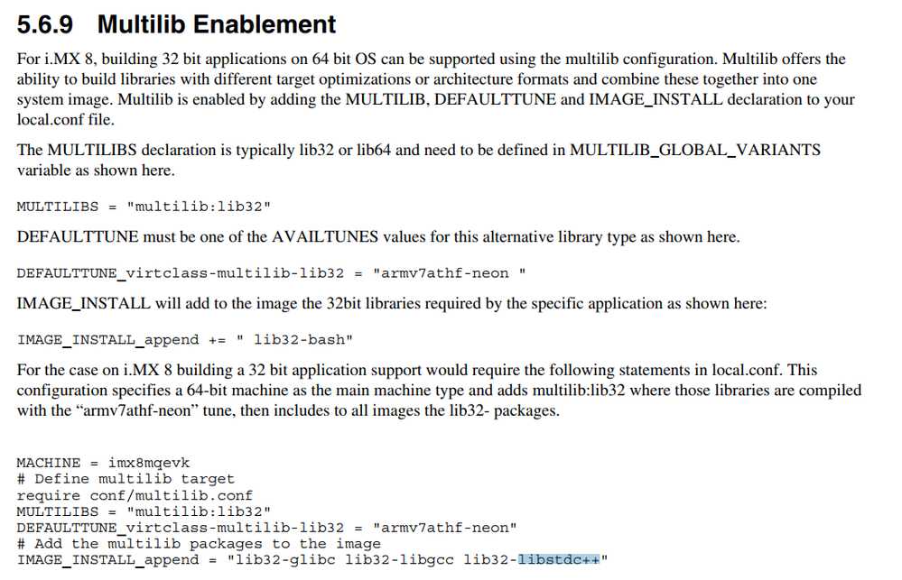

I could success cross-compile C++ file with imx8mmvek after adding the below files.
But there was another problem.
Our application made for 32bit OS. We use pointer, array etc.
(Pointer 4byte in 32bit OS, Pointer 8 byte in 64bit)
So, if we want to use our application continuously without change source, could you let me know how should we do?
