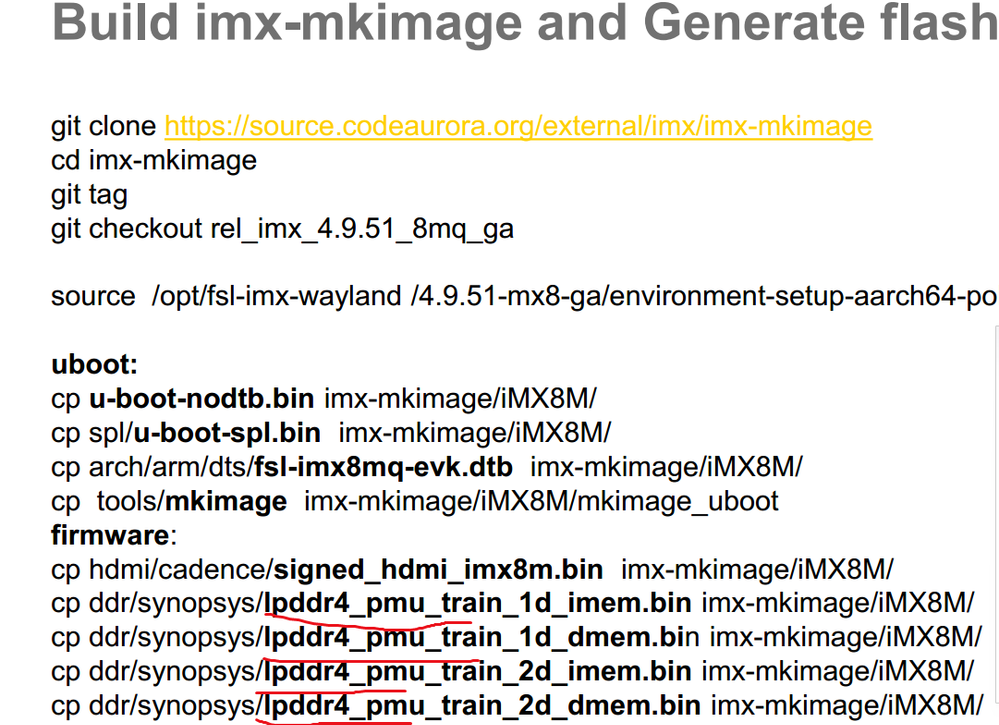

Hi ,
I'm using DDR3L on i.MX8M,  I have put two files(ddr_init.c and ddrphy_train.c) to my uboot-imx project ,and compiled success, generated  u-boot-nodtb.bin  and spl/u-boot-spl.bin ,but I don't know how to create flash.bin.
I read the standalone build  guide (i.MX8M Standalone Build.pdf),but it only described lpddr4, No DDR3 involved.
I need to generate DDR3 image(flash.bin),  how to operate ?
thanks
Muhua Luo

Hi Muhua
one can use uboot/configs/imx8mq_ddr3l_arm2_defconfig,
building steps can be found in Yocto Guide included in linux documentation on
i.MX Software | NXP
or third party tutorials
https://developer.solid-run.com/knowledge-base/i-mx8m-atf-u-boot-and-linux-kernel/
igor
