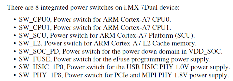

Hi All
How to control the i.MX7D integrated power switches SW_SOC_PD and SW_HSIC_1P0 turn ON/OFF ?
I can't found related document or control file, thanks.

Yuri
  please refer to section 5.5.11 (GPC PGC Memory Map/Register Definition) of
i.MX 7Dual Applications Processor Reference Manual, Rev. 0.1, 08/2016.
Yuri.
