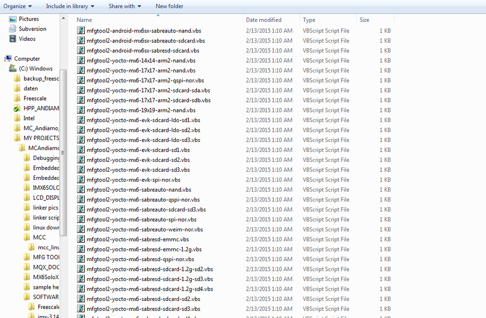

i am trying to burn the linux images to the sd card of the sabre board.How to configure the cfg.init file ? what are the parameters to be taken care of while configuring it?how it the parameter dependency on the vbscript?

but sir, there are 2  vbs files one has a prefix  of 1.2g which I didn't understand what it is?i am attaching screenshot  the vbs scripts2017-01-09_16h54_22.png

Hi Soumya
parameters for cfg.ini are taken from vbs file, just click on vbs file and
mfg tools automatically runs with parameters from that vbs file.
