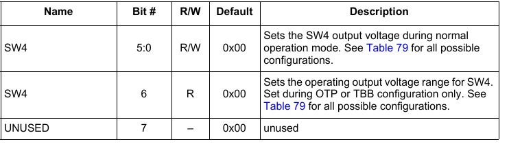

Now as per your suggestion I able to change the voltage in sw4 but I need high voltage range.
Here, SW4 [ 6:0],
6th bit is for voltage range.(Default value of 6th bit is 0)
  0 - lower voltage range
  1- Higher voltage range
6th bit is read only OR OTP.
So I need to set that 6th bit to 1.
Is there any way to change that bit.?

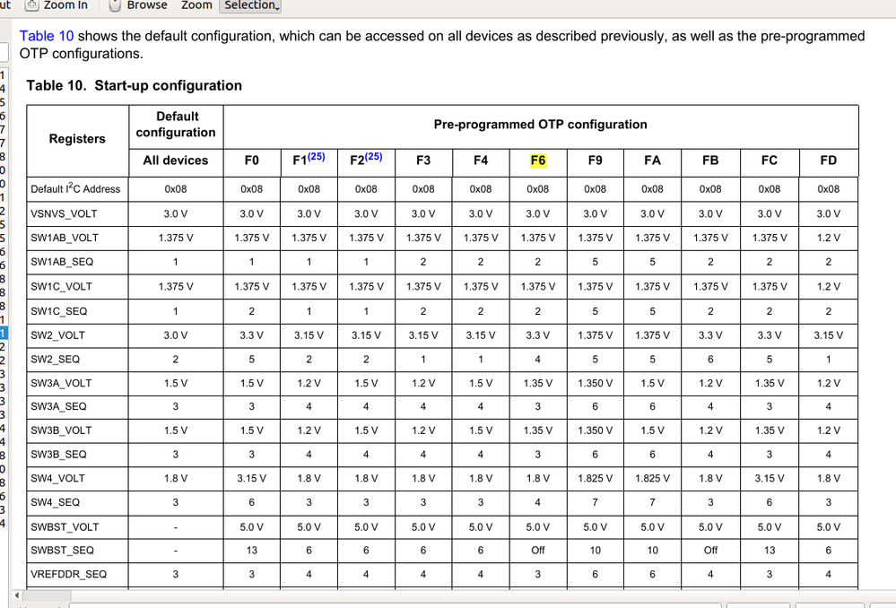

We are using PF0100 version F6.
we are able to configure sw2 well.
But we are not able to change sw4 from 1.8v to 3.3v. Here, we are able to change sw4 from 1.8v to 1.65v.
But only 3.3v is not working.
but as per datasheet,
Query#1:
1) How to change OTP or TBB configurations and change read-only bit#6?
Rakesh

igorpadykov
Hi Rakesh
one can also look at sect.6.4.4.5.1SW4 setup and control registers
MMPF0100, 14 Channel Configurable Power Management Integrated Circuit - Data Sheet
igor
1,386 Views
rakesh_patel
Senior Contributor I
igorpadykov‌:
Thanks for your support. With above guide steps, we are able to change SW4.
Rakesh
