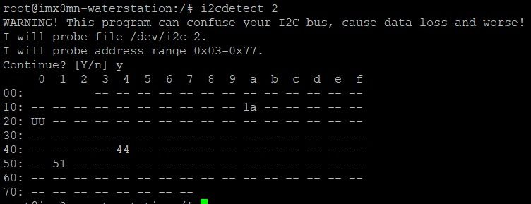

SoniaArevalo
Hello again,
I noticed that my NXP’s clock was not working, so I connected an external clock and then I could see by i2cdetect the correct addres: 0x1a.
Am I missing something that is making the clock not work? Should I modify something at dts file?

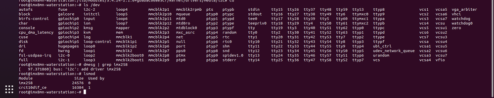

I think that the dirver is loaded, because I'm getting this information.

khang_letruong
Senior Contributor III
HI @SoniaArevalo ,
You can refer to the default imx8mn-evk.dtsi for the 24-MHz clock for ov5640. However, most of Sony's sensors require 37.125MHz, or 74.25Mhz or  54Mhz.  Therefore, I would be better to use external clock for precise timing.
You can check with lsmod command to see if it is listed. And potentially re-verify if the address 0x1a is still detected by i2cdetect (if the module with that address is failed to load, the assigned I2C address also disappears).

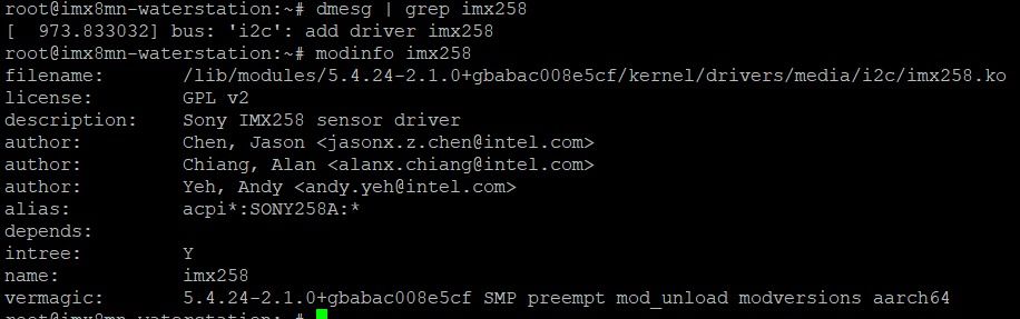

However, I can not find the way to check dev_info() or dev_error(), that I added to imx258.c file as you recommend me.
From the board's console, you can do dmesg | grep "the-message-printed-dev_info-or-dev_error"

khang_letruong
Hi @SoniaArevalo ,
Can you try to replace :
#ifdef CONFIG_ACPI
static const struct acpi_device_id imx258_acpi_ids[] = {
	{ "SONY258A" },
	{ /* sentinel */ }
MODULE_DEVICE_TABLE(acpi, imx258_acpi_ids);
#endif
with :
static const struct of_device_id imx258_dt_ids[] = {
	{ .compatible = "sony,imx258" },
	{ /* sentinel */ }
MODULE_DEVICE_TABLE(of, imx258_dt_ids);
like in the example of imx219, please ?
