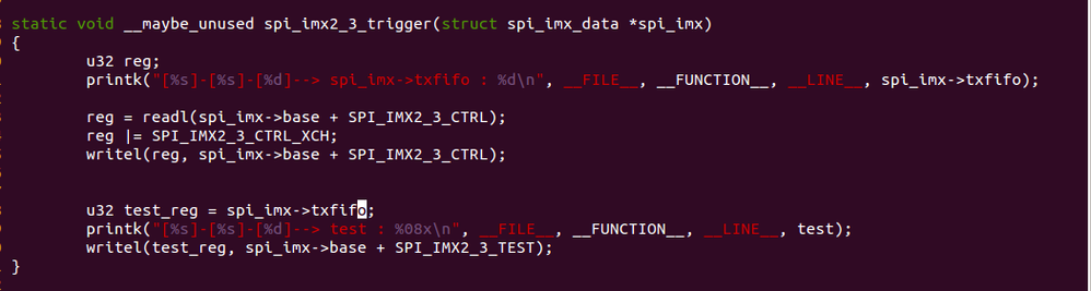

I am working on MX6q,use linux kernel 3.0.35.When I send data,use the oscilloscope to view CS signal,why I fill the ECSPIx_CONREG[BURST LENGTH] can only send 8 bits ,16 bits or 32 bits one time.Now I want to send more data one time,and the CS is low power, until the data  is send,  the CS is high power.

I am field TXCNT in register ECSPIx_TESTREG, I am send 4 byte one time,I can catch waveform. As follows,
But, I can not catch the CS is low  when send the 4 byte data. I am field TXCNT in register ECSPIx_TESTREG code,  As follows,

I can not find where avoid TX FIFO become empty.Can you show it to me ?

igorpadykov
TXCNT in register ECSPIx_TESTREG.
2,471 Views
igorpadykov
to avoid CS go high one needs to make algorithm
in such way so avoid TX FIFO become empty untill
all bits will be sent.
