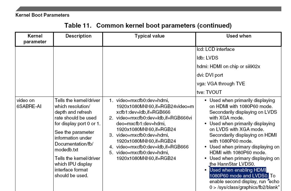

igorpadykov
Hi osmarfrisonjunior2
I think you can try command given in as attached Release Notes p.18
igor

osmarfrisonjun1
Hello igorpadykov,
Thanks for the reply.
I tried your suggestion, but it hasn't had effect (neither LVDS0 or LVDS1). Maybe because this command is for the SABRE-AI. At the previous field (SABRE-SD - page 17) LVDS0 is not mentioned.
I was thinking... If I need to change the Display configurations, I won't be able to do it, because de source code still isn't available.
Might be better to use an earlier version. What do you think?
