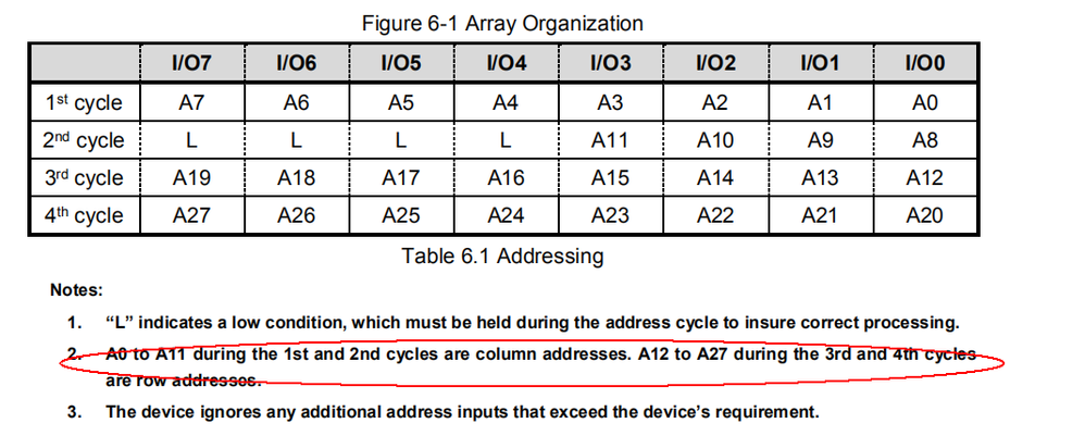

        I am using i.MX6ULL (Y2CVM08AB) and Nand flash which is W29N01HV, and the nand datasheet please refer to the attachment.  According to the datasheet, I did that following configuration, but boot_cfg2 and boot_cfg4 , I have no idea, is there anyone can help me?  thanks!
Boot Device           CFG1 [7] CFG1 [6] CFG1 [5] CFG1 [4] CFG1 [3] CFG1 [2] CFG1 [1] CFG1 [0]
NAND - W29N01HV       1          0         0          1         0         0          0         1

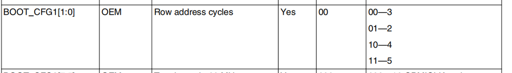

nand boot  CFG settings are described in Table 8-10. NAND boot eFUSE descriptions
i.MX 6ULL Applications Processor Reference Manual
Specific for this nand configuration can be found on p.13 nand its datasheet:
1 block= 64 pages, BOOT_CFG1[5:4] - Pages in block
4-cycles (Figure 6-1 Array Organization) , BOOT_CFG1[1:0] - Row address cycles
other BOOT_CFG can be left at default settings.

about Row address cycles I have some more questions.
4-cycles (Figure 6-1 Array Organization) , BOOT_CFG1[1:0] - Row address cycles,
do you means that BOOT_CFG1[1:0] is 10?  not 01? 2-cycles?

igorpadykov
seems you are right: Row address cycles = 2-cycles
