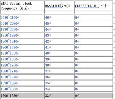

>>how should the S_CLKSETTLECTL value be selected for a sensor, based on its D-PHY clock lane frequency ?
It's value is determined by the MIPI CSI-2 VERSION OF your camera.
v0.87 to v1.00 --- > S_CLKSETTLECTL[1:0]=0
v0.83 to v0.86-----> S_CLKSETTLECTL[1:0]=2
v0.82 -- >S_CLKSETTLECTL[1:0]=3
>>About MIPI CSI-2 clock frequency
MIPI CSI-2 of CPU side must know camera's mipi clock , then configure itself.
In other words, MIPI CSI-2 of CPU side configures its own registers according to the camera's clock.
For i.MX8M MINI CSI-2:
for other frequencies, they are the same as those of i.MX7D, listed on the link:
https://community.nxp.com/t5/i-MX-Processors/Explenation-for-HS-SETTLE-parameter-in-MIPI-CSI-D-PHY-r...
Hope this information is helpful to you.
