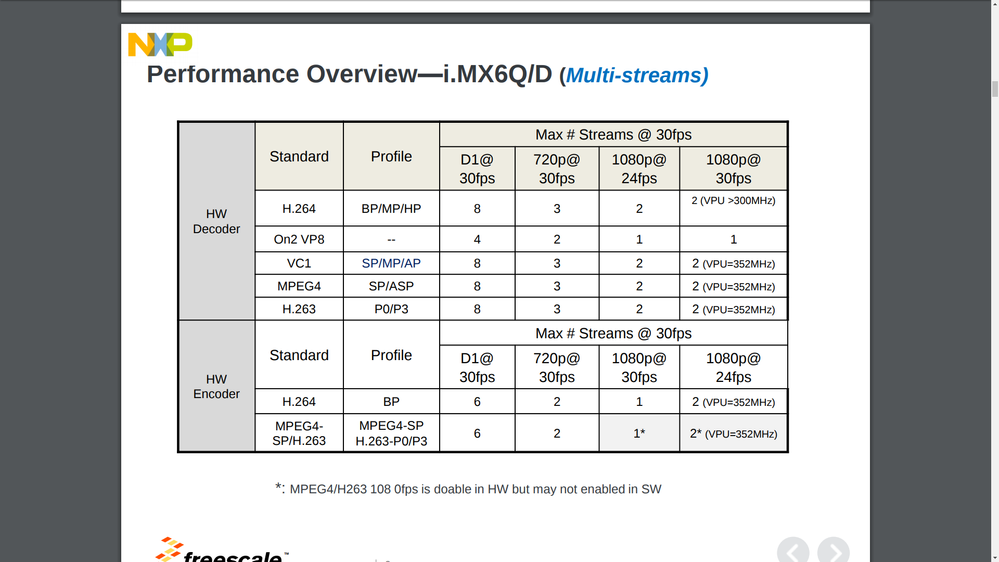

I'm using i.MX 6DualLite SABRE-SD Platform with VPU = 352MHz, with i m checking dual encoding(720x480@30fps + 1920x1080@30fps) and single decoding(192.x1080@30fps). But facing video choppy issue.
As per analysis ACodec dequeue fails.
"03-28 06:25:35.378 E/ACodec ( 700): dequeueBuffer failed."
i found vpu limitation in below spec.
Could anyone can explain, maximum possible resolution can support for my case?
Thanks in Advance!!

for encoding only one 1920x1080@30fps can be supported as described in picture,
1920x1080@30fps single decoding should be fine. One can test with Demo Images from below link

So it means, VPU we can support one 1920x1080@30fps encoding + one 1920x1080@30fps decoding can support simultaneously.
But we need additional decoding upto 1920x1080 along with 1920x1080(encoding + decoding). Is it possible?
possible with reduced perfomance.

not only 1920x1080 encoding (without simultaneous decoding).
other combinations are also possible but with reduced perfomance.
NXP BSPs provides perfomance described in Table 29. Video codec specification for hardware with VPU acceleration attached Release Notes.
