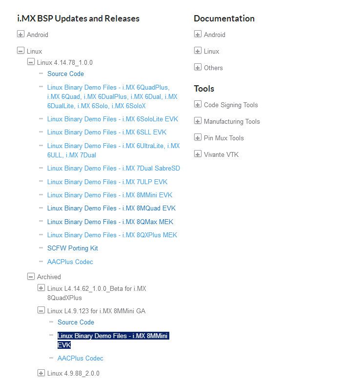

fbre
i.MX Software | NXP does not contain "Demo Images" or "uuu.fspi sample script" which you suggest. How can I find "uuu.fspi"?
13,994 Views
igorpadykov
Linux Binary Demo Files - i.MX 8MMini EVK
does contain uuu.fspi in samples folder, it is attached below.

i.MX_Linux_User's_Guide.pdf tells in chapter 4.5.13 "How to build imx-boot image by using imx-mkimage" about a collection of firmware files (also containing u-boot) packaged to one imx-boot image.
I checked my yocto Linux directory imx-yocto-bsp/build-wayland/tmp/deploy/images/imx8mmini-<mydevice> and found there a file called imx-boot-imx8mmini-<mydevice>-fspi.bin-flash_evk_flexspi of filesize about 1,1MB. (Note: I switched UBOOT_CONFIG ?? = "sd" to UBOOT_CONFIG ??= "fspi")
Is it that image which needs to be written to flash address 0x0 (e.g. by the uuu tool)?
