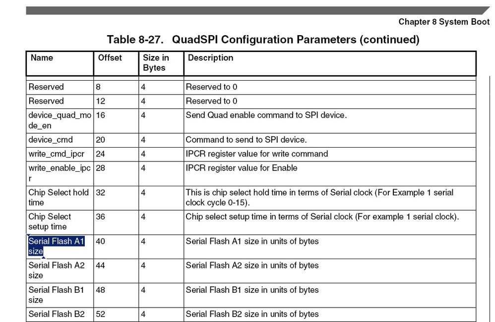

Dear All,
I want to know how to change the QSPI NOR Size.
Our development environment is like as below,
- Device/Board : i.MX6SX-SabreSD
- OS : Linux 3.10.53
- Nor Device : Micron N25Q512A13GF840F
Actually, default NOR in i.MX6SX-SabreSD is Micron N25Q256A13EF840,
the N25Q256A13EF840 is pin-to-pin with N25Q512A13GF840F.
We have to change the Size because of RootFS size.
Eric.

Hi Eric
one can change qspi size in configuration parameters, please check
IMX6SXRM Table 8-27 QuadSPI Configuration Parameters
also one can look at
Linux/Documentation/devicetree/bindings/mtd/partition.txt - Linux Cross Reference - Free Electrons
igor

Hi Igor,
Thanks for your response.
I checked the "Serial Flash A1 size" in "Table 8-27. QuadSPI Configuration Parameters".
I think I will apply the changed Serial Flash Size if I apply the below 2 items.
Is this right?
1) Modify Serial Flash Configuration File
    - change qspi-nor-micron-n25q256a-config to qspi-nor-micron-n25q512a-config
    - modified contents
      . 4000000  /*sflash_A1_size=size in byte(hex) : 64MB = 512Mb = 0x0400.0000 */
      . 0   /*sflash_A2_size=size in byte(hex)*/
      . 4000000  /*sflash_B1_size=size in byte(hex) : 64MB = 512Mb = 0x0400.0000 */
      . 0   /*sflash_B2_size=size in byte(hex)*/
    - change cfg.ini in MFGTool
      . [variable]
        norconfig=qspi-nor-micron-n25q512a-config
2) Change Partition
    - change Partition in Linux boot command line or u-boot environment like as below,
       mtdparts=21e4000.qspi:1m(uboot),8m(kernel),1m(dtb),-(user)
Eric.
