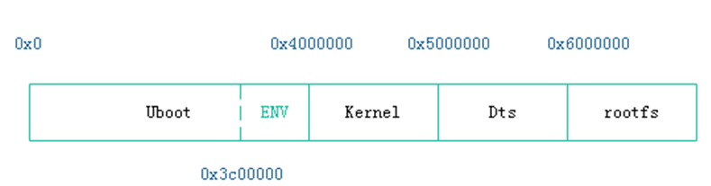

Dear all.
        the original nand partition is as follows.
      becare the uboot partition is too large ,Now I need to change partition like this:
      There is my changes:
      after this modifications, using mfg-tools, we can succeccfully upgrade.
      but after load u-boots, it failed at :
NAND read: device 0 offset 0x300000, size 0x800000
NAND read from offset 300000 failed -74
 0 bytes read: ERROR
NAND read: device 0 offset 0x1300000, size 0x100000
NAND read from offset 1300000 failed -74
 0 bytes read: ERROR
Kernel image @ 0x80800000 [ 0x000000 - 0x639b68 ]
## Flattened Device Tree blob at 83000000
   Booting using the fdt blob at 0x83000000
   Using Device Tree in place at 83000000, end 8300be76
fdt_find_or_add_subnode: memory: FDT_ERR_BADSTRUCTURE
ERROR: arch-specific fdt fixup failed
 - must RESET the board to recover.
    Is there anyone can help me?

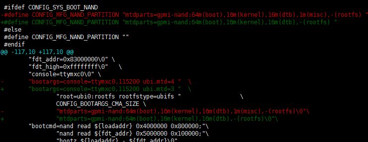

As present, the uboot version used by mfg-tools(L4.1.15_2.0.0-ga_mfg-tools) is imx_v2016.03_4.1.15_2.0.0_ga, I make some changes like this:
then replace the u-boot-imx6ull14x14evk_nand.imx both in files and firmware dirs.
but there is a strange issue, that this uboot has only successfully booted once, the rest stops at the "Starting kernel ..."
pls refer to the attachment for log.

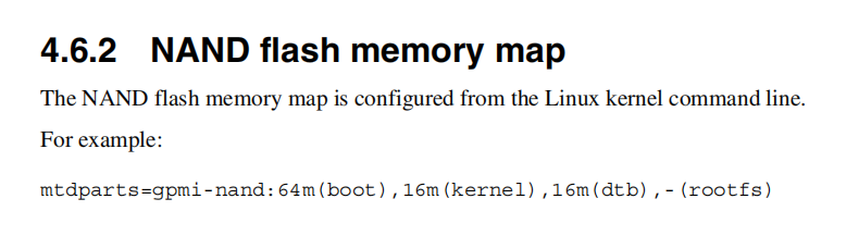

igorpadykov
Hi 国承 张
one can try with kernel command line described in
sect.4.6.2 NAND flash memory map attached Linux Guide.
igor
5,481 Views
guochgz
hello, igor,
      This part has been modified, please refer to the figure above

igorpadykov
had you tried to use this kernel command line for usual nand boot, not for mfg tool ?
igor
5,481 Views
guochgz
Do you mean to modify CONFIG_CMDLINE of kernel .config, and recompile the kernel?
Or is there another way to change this in the uboot? I find that bootargs has defined this parameter.
5,481 Views
igorpadykov
could you try nxp uboot and linux from
linux-imx - i.MX Linux kernel
uboot-imx - i.MX U-Boot
igor
5,484 Views
guochgz
