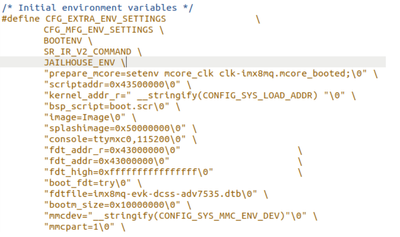

Hi All
My kernel is 5.4.70 and use imx8mq-evk.
I can use the command setenv under uboot to change the content of fdtfile from
imx8mq-evk.dtb to imx8mq-evk-dcss-adv7535.dtb and run.
I want the build image to be fixed in imx8mq-evk-dcss-adv7535.dtb after booting.
I looked for u-boot-imx/1_2020.04-r0/git/include/configs/imx8mq_evk.h file but the
content only saw fdt_file=imx8mq-evk.dtb and no fdtfile.
Which file should I modify?Thanks.

I have modified fdtfile=imx8mq-evk-dvss-adv7535.dtb in imx8mq_evk.h as shown below:
the imx8mq_evk.h path is build-wayland/tmp/work/imx8mqevk-poky-linux/
u-boot-imx/2024.04/inxlude/config/imx8mq_evk.h
But the situation is the same as before. read the fdtfile from uboot is imx8mq-evk.dtb

Ichi_
Hi @pengyong_zhang
The kernel is imx-yocto-L5.4.70_2.3.0
After modifying the imx8mq_evk.h file I executed the following command:
    1  bitbake -c cleanall imx-image-multimedia
    2  bitbake -c compile -f u-boot-imx
    3  bitbake -c deploy -f u-boot-imx
    4  bitbake -c compile -f linux-imx
    5  bitbake -c deploy -f linux-imx
    6  bitbake imx-image-multimedia
And I use uuu tool for programming, the command is sudo uuu uuu.auto
In addition, I can use this process to enable panel and touch drivers and actions.
thank you very much

Ichi_
Hi @pengyong_zhang
I have set fdt_file to imx8mq-evk-dcss-adv7535.dtb and re-burned.
But after boot, the fdtfile is still imx8mq-evk.dtb.
Thanks for your continued replies.

Ichi_
Hi @pengyong_zhang
Thank you for your reply.
As mentioned before I found the u-boot-imx/1_2020.04-r0/git/include/configs/imx8mq_evk.h file, but the content only shows fdt_file=imx8mq-evk.dtb, no fdtfile.

Ichi_
Hi @pengyong_zhang
What I want is that the fdtfile after bitbake imx-image-multimedia is imx8mq-evk-dcss-adv7535.dtb without having to modify it through uboot commands.
Do you know how to modify it?
