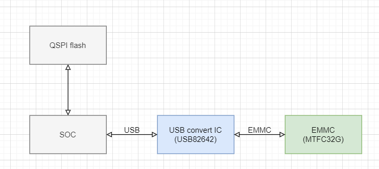

1.We don't support QSPI boot, you need refer the FlexSPI code to realize this, including enable the qspi in dts and uboot code, handle the ROM api return value.
2.uuu tool doesn't support flash image to USB device.
