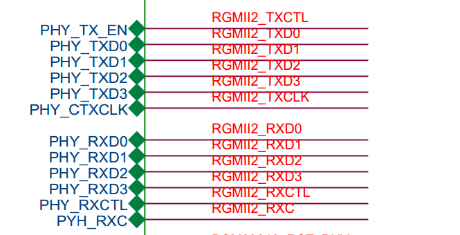

Hi all,
   We connect an external PHY through RGMII2 interface to imx6 SoloX , but the PHY interface under uboot is RGMII1, I change fec1_pads to fec2_pads,but it dosen't work .We find clk in RGMII1_TX_TXC pin.

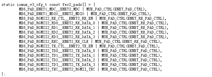

My IOMUX setting:
int board_eth_init(bd_t *bis)
      imx_iomux_v3_setup_multiple_pads(fec2_pads, ARRAY_SIZE(fec2_pads));
      setup_fec();
      return cpu_eth_init(bis);
Thank you for any feedback!

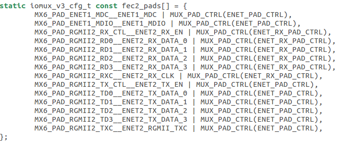

Hi igor

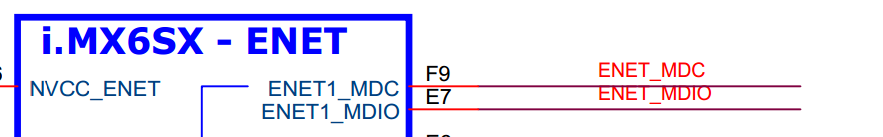

   Thank you for your answer, I modified the  iomux_v3_cfg_t const fec2_pads[] in mx6sxsabresd.c according to this document. It still dosen't work.
I checked the value of register 2
>mii read 0x19 2
>0000
the value is wrong,and part of the sch is as follows
I can use the MX6_PAD_ENET1_MDC__ENET1_MDC and MX6_PAD_ENET1_MDIO__ENET1_MDIO to read the value of the register 2
>mii read 0x19 2
>0362

igorpadykov
Hi burny
please check iomux_v3_cfg_t const fec2_pads[] in mx6sxsabresd.c
http://git.freescale.com/git/cgit.cgi/imx/uboot-imx.git/tree/board/freescale/mx6sxsabresd/mx6sxsabre...
