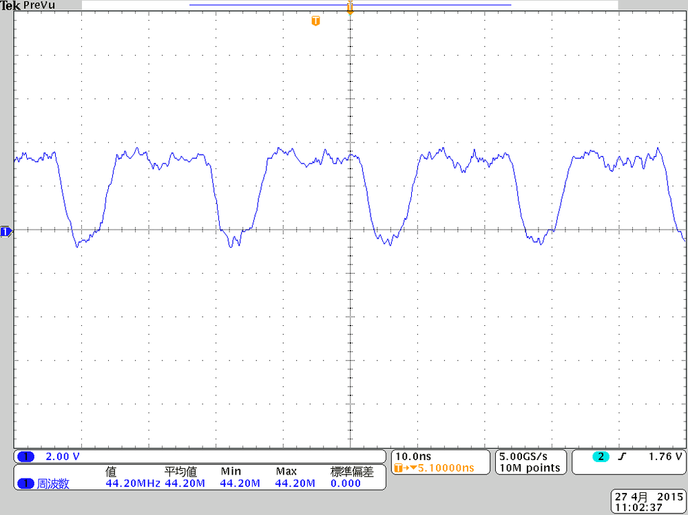

Dear all,
We connect an LCD panel to i.MX25.
LSCLK is 44.3MHz.
A frequency is 44.3MHz of the set value.
However, Duty is not 50%.
Please see the following figure.
Is there the method to change Duty of LSCLK to 50%?
We referred to a reference manual, but were not able to find the method.
Yuuki

Hi Yuuki
duty cycle is not configurable but it can be improved
by using dividers as even numbers (preferably as 2**N) for both
LCDC pixel clock rate divider and LCDC_CLK (PER DIV7).
Also increasing drive strength of clock pad may slightly
improve waveform.
igor

yuuki
Senior Contributor II
Dear Igor-san,
Thank you for your support.
We generate LSCLK=44.3MHz from AHB=133MHz.
At this case, we set PERDIV7=0(divided by 1) and PCD=2(divided by 3).
Changing AHB frequency affects the whole system.
Therefore we cannot change the AHB frequency, and PERDIV7 or PCD cannot set even numbers.
In addition, is there the method?
If there is not a method, we have to examine an LCD panel allowing this clock Duty.
Would you tell me the theoretical value of LSCLK Duty in the following setting?
May I have advice?
Yuuki

Hi Yuuki
duty cycle is not configurable, there are no methods
for its changing.
