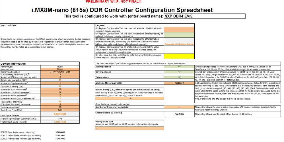

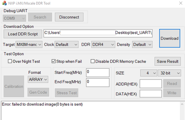

Using the provided guides, the following error occurs, while using Mscale DDR Tool:
"Error: failed to download image(0 bytes is sent)"
i.MX8 MSCALE SERIES DDR Tool Release (V3.10)
MX8M_Nano_DDR4_RPA_v2.xlsx

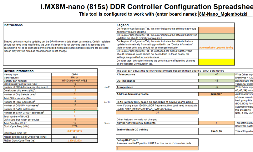

Could you please verify the configuration is right? I would expect the Number of Bank Group addresses is 2, but the field is not editable.
Further infos:
- custom board using i.MX8M-nano

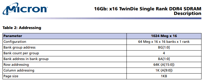

- DDR4: MT40A1G16KNR-075:E (please see addressing table below)
- PMIC: BD71847AMWV-E2 (not quiete sure, if you need this info)
- UART1

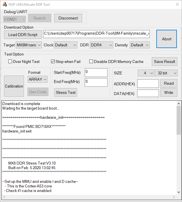

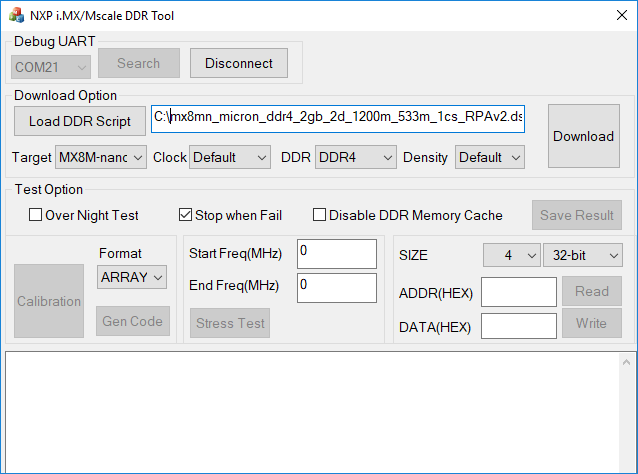

michael_glembot
Hi Bernhard, hi Yuri,
using a native Windows machine solved the download image error. Now mscale works as espected and the connection can be established. We modified the RPA, but after download the following error occurs, when accessing the DDR memory.

michael_glembot
Hi bernhardfink‌, hi Yuri‌,
could you please check my RPA (xlsx) configuration attached in the original question?
Best,
Michael

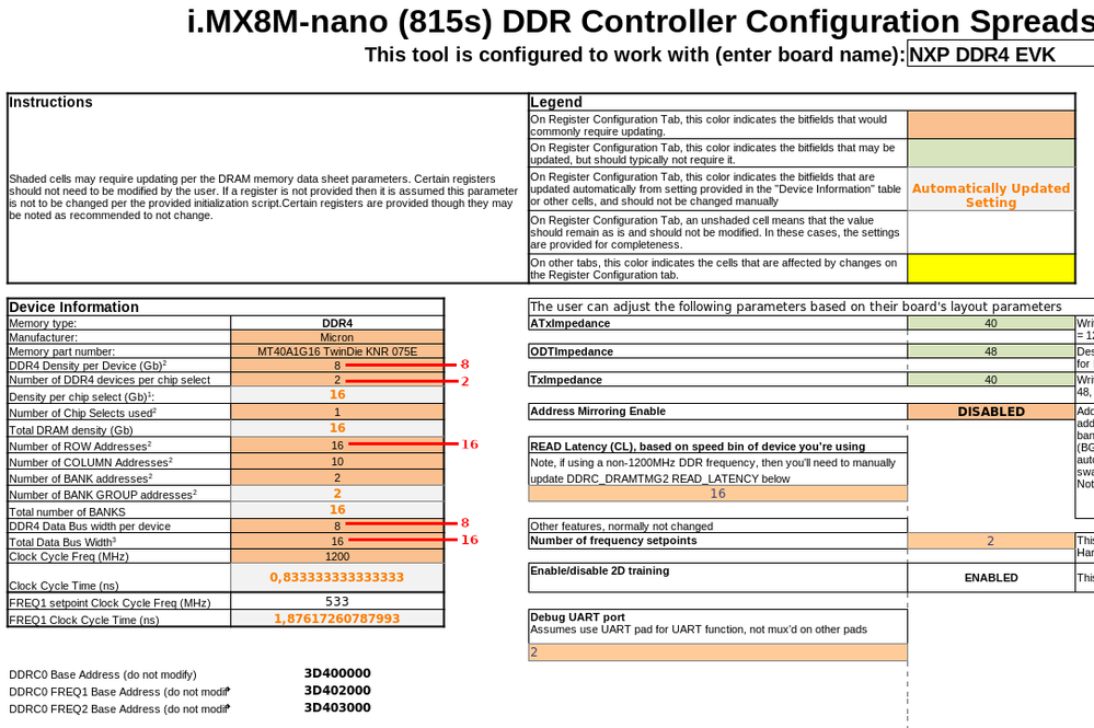

bernhardfink
Hi Michael,
this is the memory you use:  https://www.micron.com/-/media/client/global/documents/products/data-sheet/dram/ddr4/ddr4_16gb_x16_1...
This is the memory we have on the 8M-Nano EVK:  https://www.micron.com/-/media/client/global/documents/products/data-sheet/dram/ddr4/16gb_ddr4_sdram...
You have a twin-die device:  "The 16Gb (TwinDie™) DDR4 SDRAM uses Micron’s 8Gb DDR4 SDRAM die; two x8s combined to make one x16."
We have a single die device.
So there are a few differences which you need to take into account in the Excel file, see below my proposal:
Bernhard.
42,529 Views

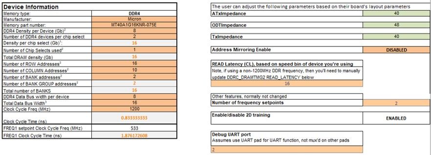

michael_glembot
Thanks for the reply bernhardfink,‌
unfortunately the proposal is not complete. I also had to update:
- DDR4 Density per Device to 8 (Density per chip select becomes 16Gb)
- DDR4 Data Bus width per device to 8 (that the number of bank group addresses is 2)
Please notice in the field "Number of frequency setpoints" only allows 1 or 2; not 3.
Nevertheless, there is no working configuration. Same error occurs: Please modify DDRC/DFI parameters!!!rpa.png
42,529 Views
bernhardfink
Hi Michael,
I will crosscheck your settings with an expert, but it seems you are right with these two settings:
For the error message during the test: did you ever try what the tool suggests "Please modify DDRC/DFI parameters!!!" ?

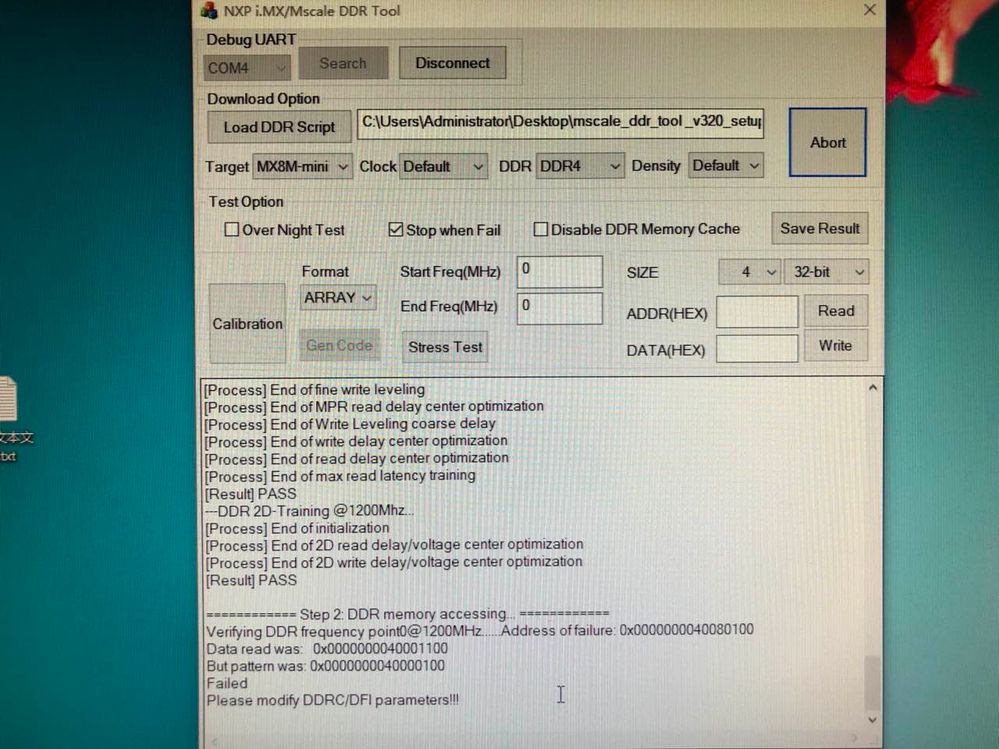

chao
Hi @bernhardfink ,
we have the same issue on our i.MX8M Mini customer board,
============ Step 1: DDRPHY Training... ============
---DDR 1D-Training @1200Mhz...
[Process] End of initialization
[Process] End of read enable training
[Process] End of fine write leveling
[Process] End of read DQ deskew training
[Process] End of MPR read delay center optimization
[Process] End of Write Leveling coarse delay
[Process] End of write delay center optimization
[Process] End of read delay center optimization
[Process] End of max read latency training
[Result] PASS
---DDR 1D-Training @668Mhz...
[Result] PASS
---DDR 2D-Training @1200Mhz...
[Process] End of 2D read delay/voltage center optimization
[Process] End of 2D write delay/voltage center optimization
[Result] PASS
============ Step 2: DDR memory accessing... ============
Verifying DDR frequency point0@1200MHz......Address of failure: 0x00000000400800D0
Data read was: 0x00000000400008C0
But pattern was: 0x00000000400000D0
Failed

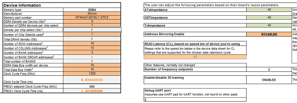

Will you please check the"MX8M_Mini_DDR4_RPA_v15.xlsx" ?
41,297 Views
bernhardfink
Your settings seem to be correct, you connected one 8Gbit DDR4 and you use 16-bit memory bus width.
The error at 0x400800D0 looks more like a electrical performance problem than a configuration problem. 2 bits are flipped.
I want to bring a new tool to your attention, which may help with this. The "Config Tool for i.MX" in version 9 includes a more powerful DDR test tool:
https://www.nxp.com/webapp/Download?colCode=PINS-IMX-WIN64-V9&appType=license&location=null

chao
Hi @bernhardfink ,
we have modified the value of ODTImpedance to 240,the error has only 1 bit flipped.
Verifying DDR frequency point0@1200MHz......Address of failure: 0x0000000040080000
Data read was: 0x0000000040001000
But pattern was: 0x0000000040000000
Failed
Verifying DDR frequency point0@1200MHz......Address of failure: 0x00000000400800C0
Data read was: 0x00000000400010C0
But pattern was: 0x00000000400000C0
Failed
Two test logs are attached.  The error seems take place at the same bit.
Do you have other suggestions?
41,250 Views
bernhardfink
Hi @chao ,
with the new DDR test tool you can maybe identify the signal lines which are performing badly. If there are impedance mismatches in the line(s), then there is nothing more you could do in software, it requires a hardware change.
Bernhard.
42,528 Views

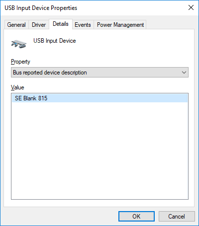

bernhardfink
Hi Brian,
this is most likely solved on your side already, I just want to finish this thread with some useful comments.
The USB connection to the chip can be tested as well with the UUU utility. If this works in some way, then you have at least verified the SDP (serial download protocol) functionality.
The DDR test GUI also uses the same USB SDP protocol to download a test firmware into the RAM of the i.MX and start it. The communication channel after the download is the UART .
If you have an 8MM or 8MN in USB download mode, then on the Windows PC side you will get a new "USB Input Device" in the Device Manager, you can verify it by checking this:  (shown for an 8M Nano)
When you start the DDR Tool, it will ask for admin rights, then you need to make the following settings:
- select the second COM port in the list (for 8MM and 8MN EVK), on your own board of course the one you connected and at the same time specified in the Excel file
Just to be sure, make a fresh reset of the board and then click on Download, you must get the following:
Bernhard.
