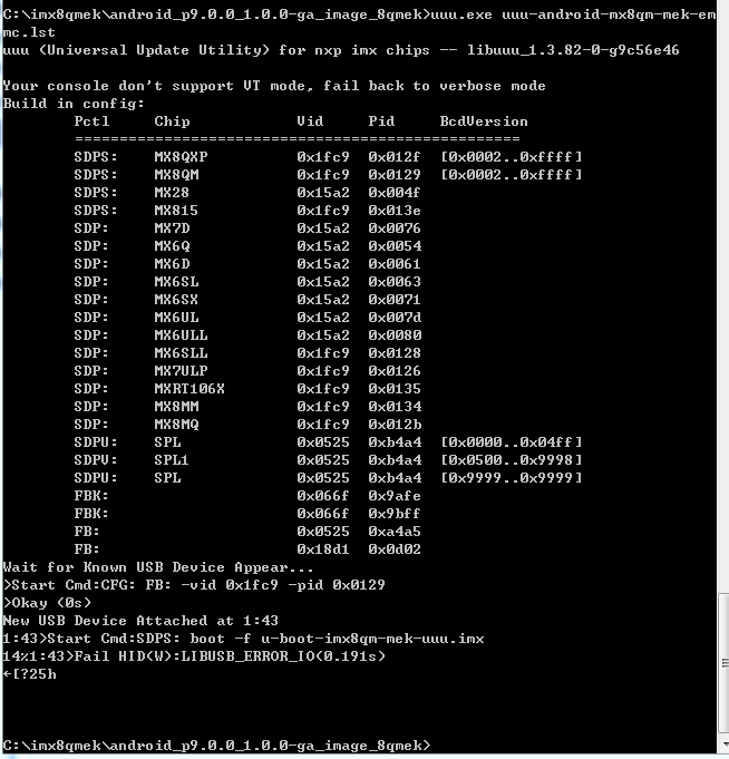

Are you using linux or android BSP?Here you can use the uuu tool to download. If you are first use you can see Get Started with the MCIMX8QXP-CPU | NXP  to boot up the board. Or you can see the user guide documents you can download here i.MX 8QuadXPlus Multisensory Enablement Kit | NXP
2,424 Views
tangl
It happens a issue that shows "LIBUSB_ERROR_IO", How should l do with it?QQ图片20200323140639.png

Does the usb diver install on your PC?
