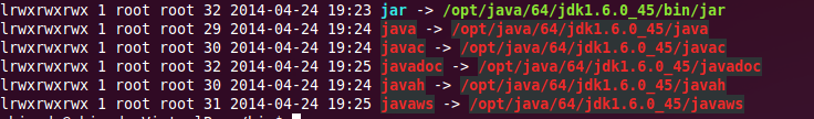

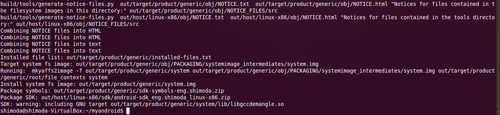

6,205件の閲覧回数
satoshishimoda
Senior Contributor I
Hi Jay Tu,
I have installed javadoc as the attached image with How to install Sun's JDK in Ubuntu for Android build.
However, the javadoc error was occurred.
Then, the error was resolved after the following command.
export PATH=$PATH:/opt/java/64/jdk1.6.0_45/
The build  result was the following image.
I think build was finished correctly, do you think so?
6,205件の閲覧回数
JayTu
Yes, I think so.
