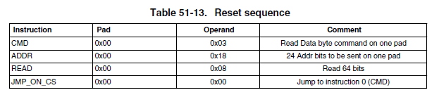

florian_germain
Witout Freescale support i solved my problem.
The problem was in the QSPI configuration parameters.
This is the workaround i found to switch from micron n25q256a to n25q128a:
- sclk_freq=0 (change frequency to 18MHz)
- sflash_type=0 (single mode)
- ddr_mode=0 (disable ddr mode, because this flash don't support DDR mode)
- change LUT:
               CMD - 0 - 0x3D
               ADDR_DDR - 0 - 0x18
               DUMMY - 1 - 0x06
               READ_DDR - 1 - 0x04
               JMP_ON_CS - 0 - 0
become now:
               CMD - 0 - 0x03
               ADDR - 0 - 0x18
               READ - 0 - 0x08
               JMP_ON_CS - 0 - 0
So 2818 043d 3904 0d06 2400 become 0818 0403 2400 1c08
This LUT sequence use the default read sequence used by IMX to read parameters:
This method should works on most of flash, because it is used to read QSPI parameters.
The "problem" is that it is "1 wire -18MHz", so it is slow.
But in my situation, i use QSPI flash for debug, so no problem.
