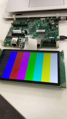

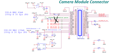

I tried to run the mipi_csi_rgb_cm7 example on MIMXRT1170-EVK and changed the camera's MIPI data channel output from two pairs to one pair.
In order to match the timing of MIPI, I adjusted the resolution from 1280*720*30fps to 1280*720*15fps,

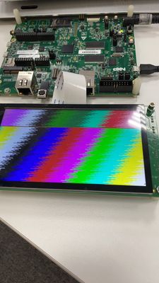

The camera signal can now be received, but the LCD panel cannot output the correct image.
Attach the normal output image  and the corrected error image
In addition to modifying the data channel settings, what else needs to be adjusted?

To be prudent, I'd like to confirm with you about the below inquires.
1) According to your statement, you want to receive the camera video data via one pair as the below figures show, is it right?
2) The below figure doesn't seem like the data from the camera, can you explain it?
Further, I was wondering if you can introduce the cod modification you did about the evkmimxrt1170_csi_mipi_rgb_cm7 demo.
