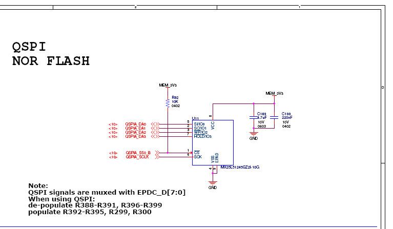

Currently uboot not include "sf probe" command, we need to tried SPI NOR flash,so how to add "sf probe" command in uboot, thanks.

Hi Felix
below part if i.MX7D SDB SPF-28590 schematic p.9 for qspi usage
also please check uboot configs CONFIG_SYS_USE_QSPI
in include/configs/mx7dsabresd.h
igor

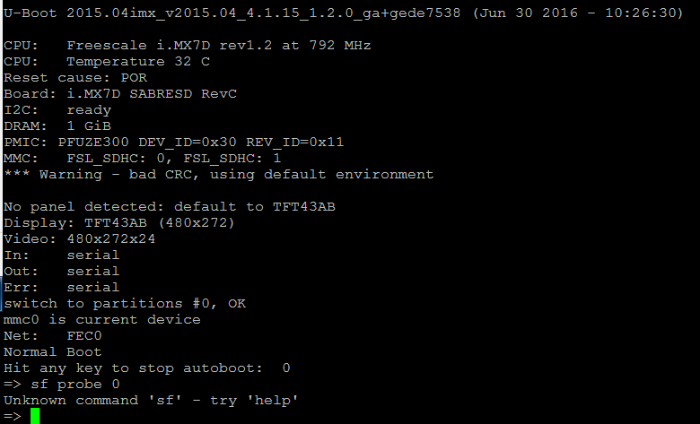

felixhsu
Hi Igor
As below photo is my operation log, key in "sf probe 0" uboot will show Unknown command, how to add "sf" command on build uboot by myself, thanks.

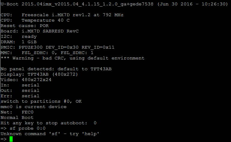

igorpadykov
Hi Felix
suggested document on p.15 shows another:
sf probe 0:0
igor
8,156 次查看
felixhsu
Hi Igor
it still fail on uboot, as below is operation log, thanks.
