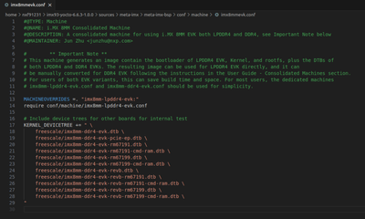

It appears that procedure only works in an standalone environment.
Please try adding your device tree in your machine.conf.
for example:
yocto/sources/meta-imx/meta-imx-bsp/conf/machines/
And add your device tree there (for example imx8mmevk.conf):
Salas.
