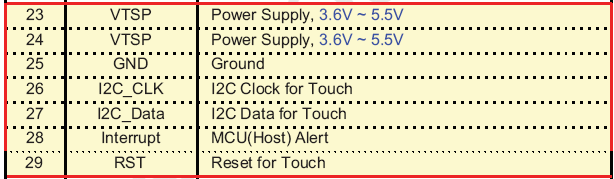

I wish to add cap touch screen driver into yocto image, so that my touch lcd panel can work. I am new to achieve this feature, so pls some expert tell me entire steps to achieve it. the following is my guess, maybe it is not correct or not entire, so pls correct me, thanks.
my touch panel is capicator type, I2C interface (pls see picture below), 30ea(X)x42ea(Y), LCD PANEL pixels is 1366x768 and 10.1 inch size.
my software is core-image-x11
I guess I need to modfy : (pls correct me if i miss sth or am mistaken)
1: modify dts
   a>add touchpanel definition, like
         touchscreen@xx {
          compilant <folder,driver>
          reset pin =
          int pin =
          interrupt =
  b>interrupt@xx {
      touch int =
  c>I2C@XX {
     sth
2: add touch.c in some folder
3: modify xorg file add the following:
SECTION
touch sth

Hi wz
one can look at examples with new touchscreen support at:
i.MX6 max11801 touchscreen can't work
https://boundarydevices.com/tweaking-froyo-for-nitrogen-part-1-touch-support/
igor
