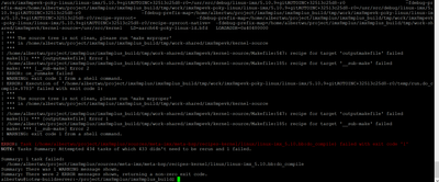

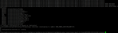

t2865k5
Dear NXP,
(1) make mrproper
(2) make ARCH=arm64 defconfig
(3) bitbake linux-imx -f -c compile
(4) bitbake linux-imx -f -c deploy
(5) Please refer to the pictures and the fail message appears
Please help fix this issue .
