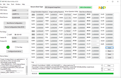

Thanks, @jay_heng Now I have set up the MCU Boot utility to burn the fuse 0x840[2]. Here is a snapshot of my fuse map. This is the first time I am burning fuses so I am a bit nervous because I don't want to mess it up. Please confirm whether should I write 0x00000004 in the 0x840 fuse section to burn the required fuse.
5,182件の閲覧回数
jay_heng
value 0x00000004 is Correct, but i would like you to write 0x0000000c.
as this word field is write-once (even write 0), so we should better to enable XECC and MECC at the same time

ZohaibAli
@jay_heng Ok I burned the fuse and now the MECC64 is in action, its error status flags are depicting the error it detects. I am facing two issues now:
1. Interrupts are still not triggering, I have enabled module interrupts and also enabled MECC1 and MECC2 interrupts globally in NVIC.
2. When I inject "0xff" as an error in data it does not detect the multi-bit error. I tried with "0x3" and it detected the multi-bit error correctly. Is it because MECC can only detect up to two bits of error?
