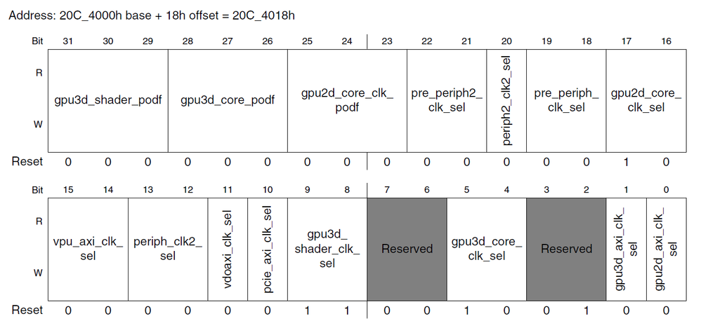

Dear All,
The CCM_CBCMR register controls the clock source for the MMDC (memory controller) interfaces. The i.MX6 ROM configures this register so that the MMDC_CH0_CLK_ROOT and MMDC_CH1_CLK_ROOT clocks are sourced from the PLL2 main output (528 MHz). We can change these clocks to the PLL2-PFD2 output which runs at 396 MHz by adding the following lines into your DCD file in U-boot.
/* Configure MMDC clocks for 396 MHz operation */
DATA 4 0x020C4018 0x00260324
Hex 0x00260324 = Binary ‭0010 0110 0000 0011 0010 0100‬
1) To change MMDC_CH0_CLK_ROOT and MMDC_CH1_CLK_ROOT clocks which Bits should be changed from the following ? We can see with above hex settings; Are the only following bits will change above clock root clocks ?
Bit 21,22 = pre_periph2_clk_sel = PLL2_PFD2 = 396MHz
Bit 18, 19 = pre_periph_clk_sel = PLL2_PFD2 = 396MHz
2) Don't we need to set  following bits to PLL2_PFD2 as well ?
Bit 16, 17 = gpu2d_core_clk_sel
Bit 15, 14 = vpu_axi_clk_sel
Bit 4, 5 = gpu3d_core_clk_sel
Register Name = CCM Bus Clock Multiplexer Register (CCM_CBCMR)
Address = 20C_4018
Peter.

Hi Peter
1. I think that using pre_periph2_clk_sel , pre_periph_clk_sel is correct.
Some examples can be found in SDK (core/src/ccm_pll.c)
Github SDK
https://github.com/backenklee/swp-report/tree/master/iMX6_Platform_SDK
Note if uboot is running from ddr, these modifications should be performed
running code from OCRAM.
2. if gpu,vpu are not used, no need to change these settings.
igor
