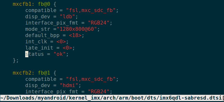

How to Add 24-bit LVDS Support in Android 5.0 IMX6DL and IMX6Q,
how to config the device tree? Any document about this?
DISP0_EN is connect to the DI0_PIN15
LCD module is LP101WX2

igorpadykov
Hi lin
for such dtsi example one can look at
linux-imx6/imx6qdl-eo.dtsi at boundary-imx_3.14.28_1.0.0_ga · boundarydevices/linux-imx6 · GitHub
https://boundarydevices.com/android-lollipop-5-0-0-ga-release-for-i-mx6-boards/
https://boundarydevices.com/mx6-device-tree-customization/
igor

linw
In Android 4.3 I config as follow:
1. bootargs:
console=ttymxc0,115200 init=/init video=mxcfb0:dev=ldb,LDBXGA,if=RGB24,bpp=18 ldb=sin0 video=mxcfb1:off video=mxcfb2:off fbmem=10
M fb0base=0x27b00000 vmalloc=400M androidboot.console=ttymxc0 androidboot.hardware=freescale
in ldb.c:
static struct fb_videomode ldb_modedb[] = {
         "LDB-XGA", 60, 1280, 800, 13623,
         80, 48,
         15, 2,
         32, 47,
         0,
         FB_VMODE_NONINTERLACED,
         FB_MODE_IS_DETAILED,
In Andorid 5.0 :
1. bootargs:
M fb0base=0x27b00000 vmalloc=400M androidboot.console=ttymxc0 androidboot.hardware=freescale androidboot.selinux=disabled android
boot.dm_verity=disabled
2:dts: mxcfb1 config as follow,I was confuse, How to config the LVDS0 pins in tthe DT?
