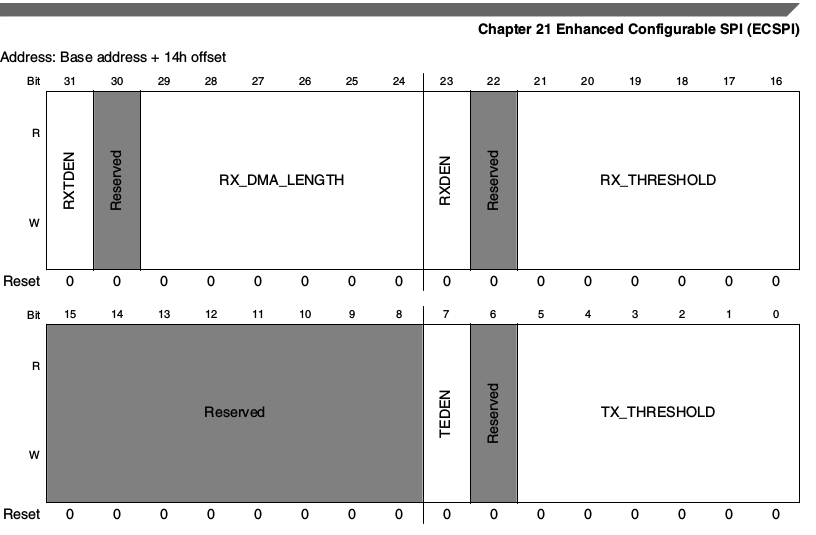

I am using the IMX6Q development board of NXP official website. When I was using SPI for communication, I found that the SPI only uses DMA transfers when the bytes I transfer are larger than 64 bytes. When my data volume is less than 64 bytes, the SPI uses GPIO transmission. In my actual project, every byte I transfer is less than 64 bytes. However, because of the large amount of data, it is desirable to use DMA for transmission. Do you have any good suggestions?

From the Reference manual chapter 21:
User need to configure ECSPI.DMAREG register to enable the data transfer of ECSPI via DMA when the appropriate conditions are matched, the block will send out a DMA request. ECSPI.DMAREG register's field 7 is responsible for enables/disables the TXFIFO Empty DMA Request and field 0-5 (TX THRESHOLD shown in attached picture) is responsible to defines the FIFO threshold that triggers a TX DMA/INT request and a TX DMA/INT request is issued when the number of data entries in the TXFIFO is not greater than TX_THRESHOLD.
Here from the reference manual, i didn't found the default value but it is configurable using ECSPI.DMAREG.
For your reference page no. 990 (i.MX 6Dual/6Quad Applications Processor Reference Manual)
I hope this helps!

hi,Radhika Somaiya
   I modified the dma register based on the information you provided. At the same time I forced the change of
transfer->len > spi_imx_get_fifosize(spi_imx). Let all the data be transmitted via dma. Although my data was finally transmitted via dma, the data received was confusing and erroneous.
I would like to ask why there is a restriction of transfer->len > spi_imx_get_fifosize(spi_imx). Also want to know how to change this limit.

864535720
hi,Radhika Somaiya:
   First of all, thank you very much for your help.
   I mainly modified the following places:
  1、 ECSPIx_DMAREG    (RX_THRESHOLD  TX_THRESHOLD)
   2、spi_imx->tx_config.dst_maxburst
   3、spi_imx->rx_config.src_maxburst
   4、The return value of the spi_imx_can_dma() function
first:
   When I set RX_THRESHOLD to 0x00
                     TX_THRESHOLD is set to 0x3f
result
   When the transmitted data is less than 64 bytes, spi uses PIO for data transmission and the transmission is successful.
   When the transmitted data is larger than 64 bytes, the kernel prints the following information::
   can't send spi message: Connectiospi_master spi1: failed to transfer one message from queue
    n timed out
    Aborted
next:Next, I modified it again in the spi_imx_sdma_init function.
      spi_imx->tx_config.dst_maxburst = 1;
      spi_imx->rx_config.src_maxburst = 1;
result
   When the transmitted data is larger than 64 bytes, the dma transmission is used and the transmission is successful.
Next, I made changes in the spi_imx_can_dma function. I forced the spi_imx_can_dma() function to return true even if transfer->len < spi_imx_get_fifosize(spi_imx)
result
   When the transmitted data is less than 64 bytes, spi uses dma for data transmission and the transmission is successful.
So I think it might be a problem with spi_imx->tx_config.dst_maxburst and spi_imx->rx_config.src_maxburst. But in the file dmaengine.h it says:

864535720
Data can now be received normally.
But for the configuration involved in the program, I still feel a little problem. For example: when I set this up: spi_imx->tx_config.dst_maxburst = 32;
Spi_imx->rx_config.src_maxburst = 32;
The kernel will print: spi_master spi1: I/O Error in RX tail
Problems arise during the transfer of data.
Can you provide some other information for me to refer to?
