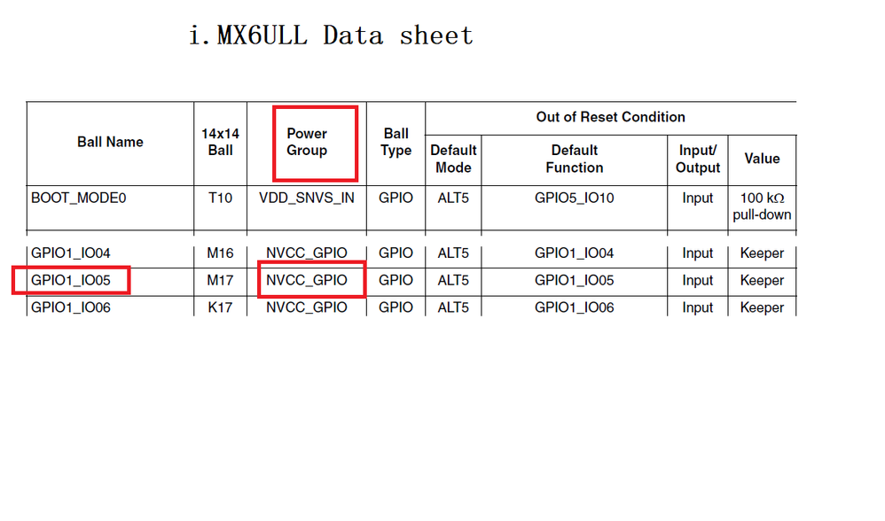

Here is my experience.
The power main of i.MX6ULL can be found in i.MX6ULL datasheet.
For example:
NXP Semiconductors
Data Sheet: Technical Data
Document Number: IMX6ULLIEC
Rev. 1.2, 11/2017

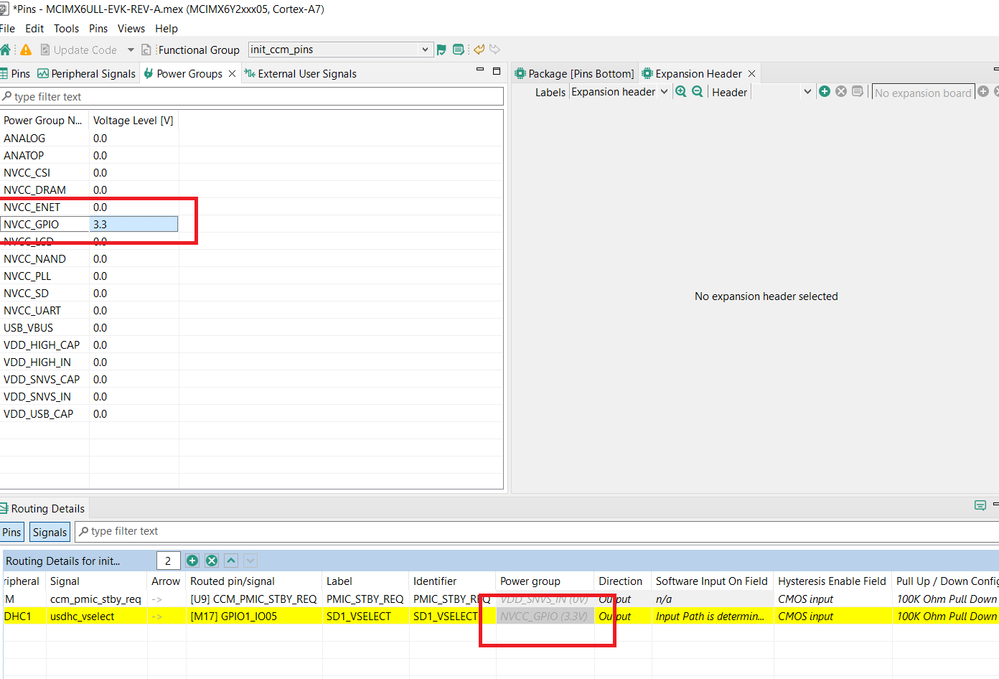

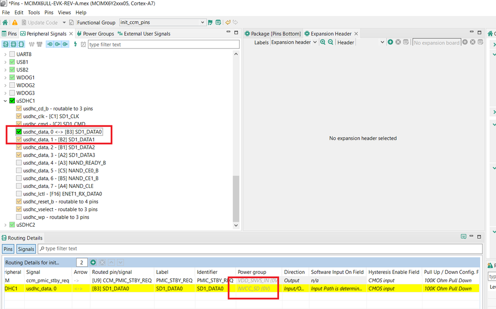

You question about the pad/pin GPIO_IO05 power domain can be found following the NVCC_GPIO.
I usually use pins tool/ config tool to help me.
The tool can show lots of information, you do not have to search the document.
pins tool/config tool
suggest you give the real power voltage like below. If has power domain conflict, the tool will give you warning.

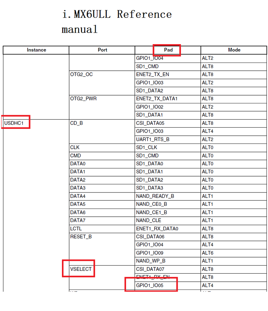

Sometimes you are free to select alternate pins.
However, the pin chosen determines the power domain. Changing the purpose of the pin through the mux cannot change the domain is my understanding.
In the case of VSELECT, it must be known to the hardware and cannot be any GPIO. For USDHC1, VSELECT is one of only three pins:
GPIO1_IO5: NVCC_GPIO
ENET1_RX_EN: NVCC_ENET
CSI_DATA07: NVCC_CSI
For USDHC2, VSELECT is one of only two pins:
ENET1_TX_DATA0: NVCC_ENET
GPIO1_IO08: NVCC_GPIO

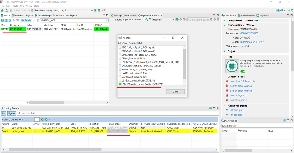

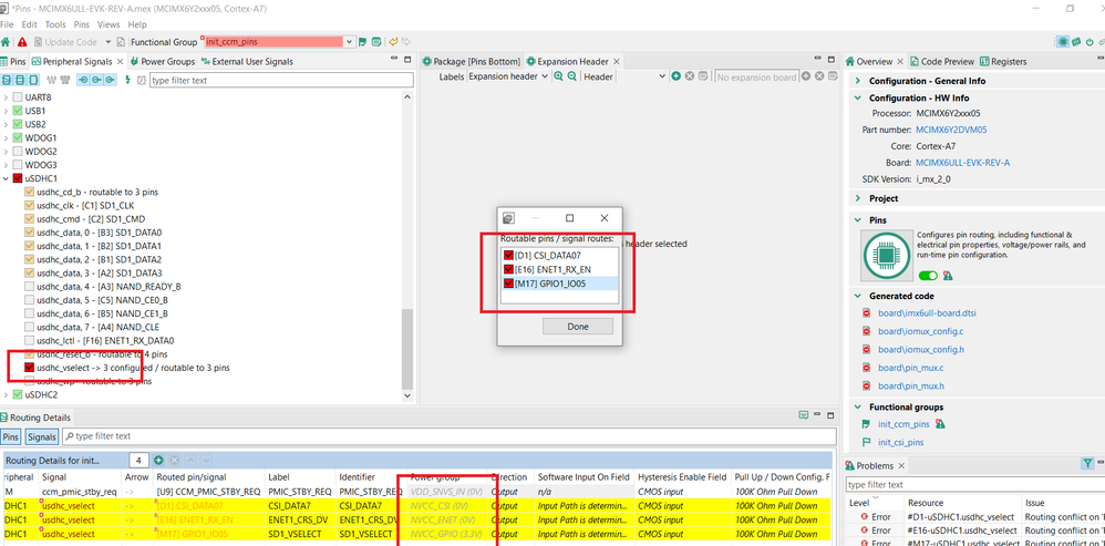

Mestkim
The NVCC_SD should be the usdhc data IO pins. Not for VSELECT pin.
The VSELECT pin be configured by
CSI_DATA07, ENET_RX_EN, GPIO1_IO05
and its power domains are  NVCC_CSI, NVCC_ENET and NVCC_GPIO
Because I want put all of those pads/pins information together , so the pins tool/config tool found conflict and give strong red error.
