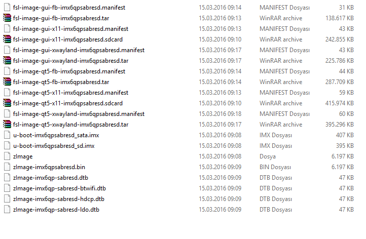

aydinalci
Hello Artur,
Now i am trying it with Ubuntu on virtual machine. And i downloanded BSP files you suggested above. But there were no files in image format just zImage, u-boot and fls files are existed in the folder(i attached the picture below about it).
So in this case, should i skip 4.3.2 part of the document you shared above and do i have to set up partitions manually to SD card according to 4.3.3 part and rest of the following instructions?
Or, should i compile these files to make it in image format and then to copy to SD card ?
Thanks.
6,979 Views
art
You have to skip the Section 4.3.2 and follow 4.3.3 and below.

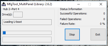

I am using IMX.6QuadPlus SABRE board for Automotive Infotaintment and there was no sd card inside of the package for the first booting when it was delivered to me. So i am trying to boot it from Windows PC. Let me explain my booting procedure step by step and please you alert me if i made anything is wrong.
1 - I checked cfg.ini and UICfg.ini files but i didn't  make change anything inside of them. So are they need  to anything is change for my board decribed above. If they are, please can you indicate what they should be for the begining ?
2 - So i followed the procedure like that, i connected a USB cable from the computer to USB - OTG port on the board. And i connected a USB cable from the OTG to UART port to the computer for console output.
3 - Then i opened the my terminal emulator program(i am using PuTTY)
4 - Then i set the boot pin on the board to MFGTOOL Mode according to Serial Download Mode. (S3 dip switch -> only D2 is on, rest of them are off)
5 - Then i opened the mfgtool.v2. It run but durring the proccest i was stopped the action. You can see the picture is attached below and also there was no action on my serial terminal monitor on the PC.
All during the procces SD card is installed on the board and other dip switches are in default settings.
