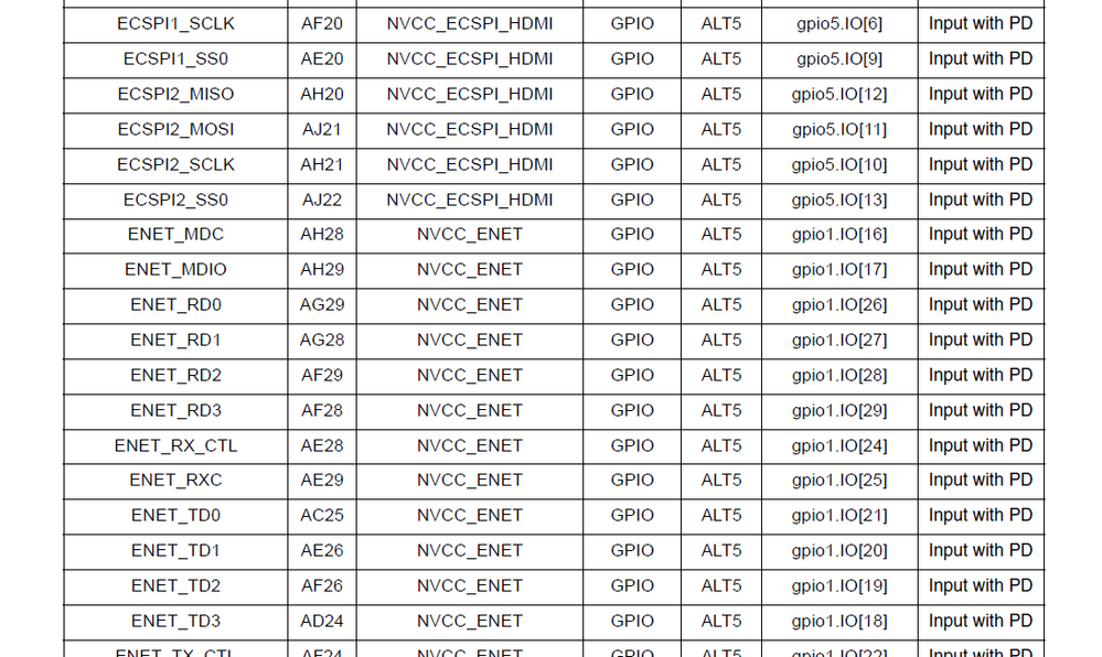

Pins have a three-state logic. If no device is enabled, then the pins are in high impedance state. It means that the output driver is not controlling the state of a connected circuit.
If you set IOMUX as alt GPIO  and GPIO is input. there is no output path.
For the input path, it is high impedance, that is it could be an "input".
That is why most of pin/pad default alt is GPIO and the GPIO default is input.
Silicon designer designs this to make the chip default high impedance on I/O.
you also can see in the linux, it will change the pin/pad to gpio make it high impedance during the suspend to avoid some power leaking.

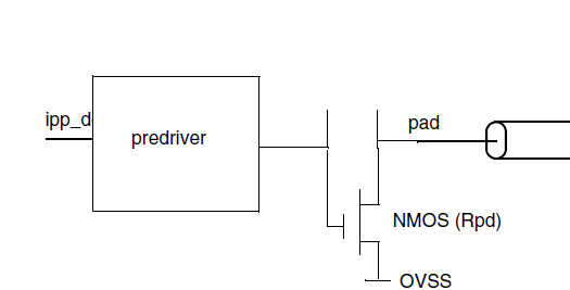

When no output path, the PMOS and NMOS are both open.
BTW, the pull up/pull down is on the right side of the CMOS.
For the open-drain, it is not silicon default, you need to set it.
It is easy to do, the settings for open-drain is just disconnect the PMOS.
