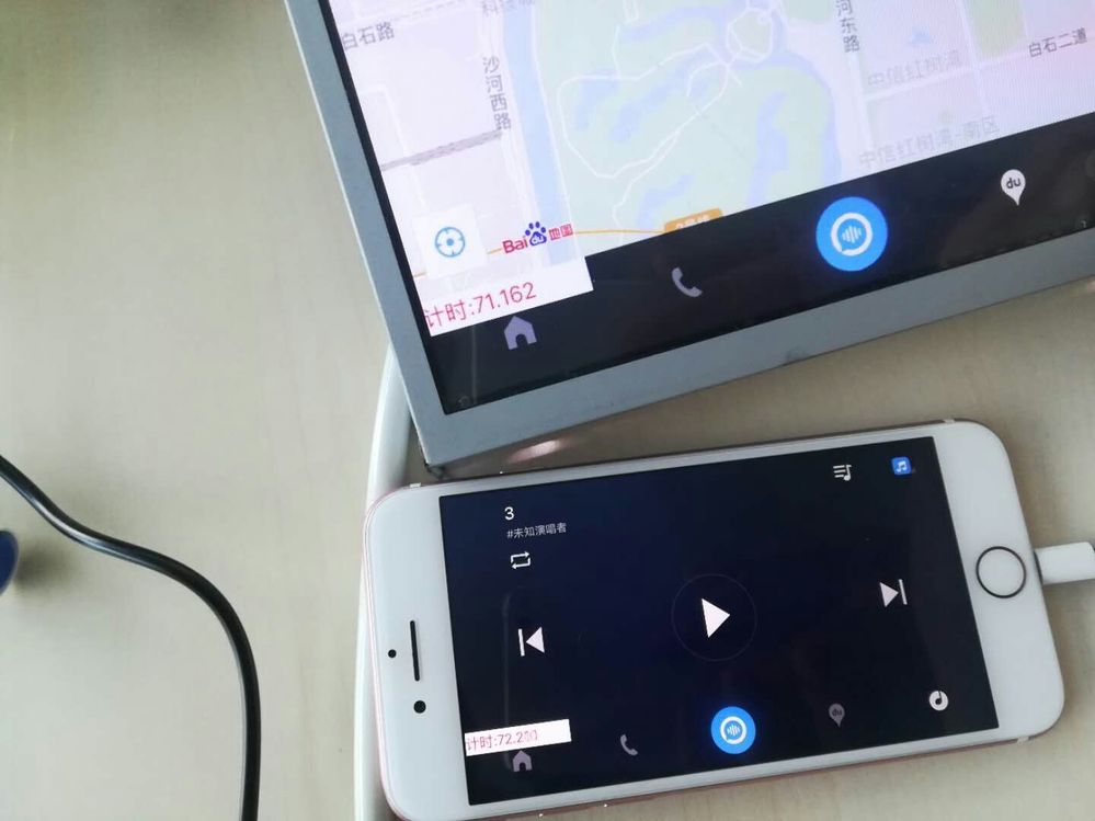

Project platform information:
DSP: i.MX6DL
OS: KK4.4.2
Kernel:3.0.35
DDR:1GB
eMMC:16G
Hi FSL Guys,
According the picture above, you will find there is a around 1 second delay between the iPhone and navigation unit on CarLife. But for Android phone, the delay time is200-300 ms. Baidu guys said the long delay of iPhone may by caused by i.MX6, USB or decoder. But i cannot where i can improve. Could you advise me the possible cause?

xiaoqianlin
The function SetParametor with OMX_IndexParamVideoDecReorderDisable(OMX_DECODER_REORDER) is used to disable reorder.
diff --git a/OpenMAXIL/src/component/vpu_dec_v2/VpuDecComponent.cpp b/OpenMAXIL/src/component/vpu_dec_v2/VpuDecComponent.cpp
index 2cbd9f1..29d0553 100755
--- a/OpenMAXIL/src/component/vpu_dec_v2/VpuDecComponent.cpp
+++ b/OpenMAXIL/src/component/vpu_dec_v2/VpuDecComponent.cpp
@@ -1290,7 +1290,7 @@ OMX_ERRORTYPE OpenVpu(VpuDecHandle* pOutHandle, VpuMemInfo* pInMemInfo,
                               decOpenParam.nChromaInterleave=0;
-              decOpenParam.nReorderEnable=(bReorderDis==OMX_TRUE)?0:1;           //for H264
+             decOpenParam.nReorderEnable=0; //(bReorderDis==OMX_TRUE)?0:1;   //for H264
               switch(eCodeFormat)
                               case VPU_V_MPEG4:
