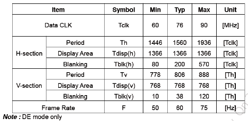

I'm trying to configure the device tree for a new display (1366x768, 60hz). I want to use it under Linux 3.10.53 as framebuffer device. With the following configuration I get a distored image:
display_fb1: fb@0 {
    compatible = "fsl,mxc_sdc_fb";
    disp_dev = "ldb";
    interface_pix_fmt = "RGB24";
    default_bpp = <32>;
    int_clk = <0>;
    late_init = <0>;
    status = "okay";
&ldb {
    status = "disabled";
    lvds-channel@1 {
        crtc = "ipu2-di1";
        fsl,data-mapping = "spwg";
        fsl,data-width = <24>;
        status = "okay";
        primary;
        display-timings {
            AUO15Zoll1366x768: AUOG156XW01V1 {
                clock-frequency = <76000000>;
                hactive = <1366>;
                vactive = <768>;
                hback-porch = <0>;
                hfront-porch = <0>;
                vback-porch = <0>;
                vfront-porch = <0>;
                hsync-len = <194>;
                vsync-len = <38>;
                de-active = <1>;
If I only change the hactive value to 1364 or 1368 for example the image looks okay. How do I get it to work with a value of 1366?

Hi Oliver
device tree timings should be filled with data from LCD datasheet, please
use example below
https://community.freescale.com/thread/373763
igor

That's what I did:
And that's how it looks like :-(
722 Views

I read the thread but they have a different issue. In my case the penguins are only distored with a resolution of 1366x768. When I change the resolution to 1364x768 or 1368x768 it looks perfect.
